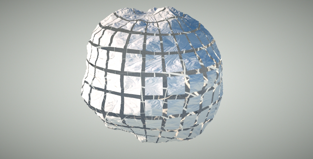

For the displacement, below is what i get when i apply
the mountain displacement to a sphere (all points are welded)
Thanks again for your help
Oliv
juanjgon
Posts: 8867
Location: Spain

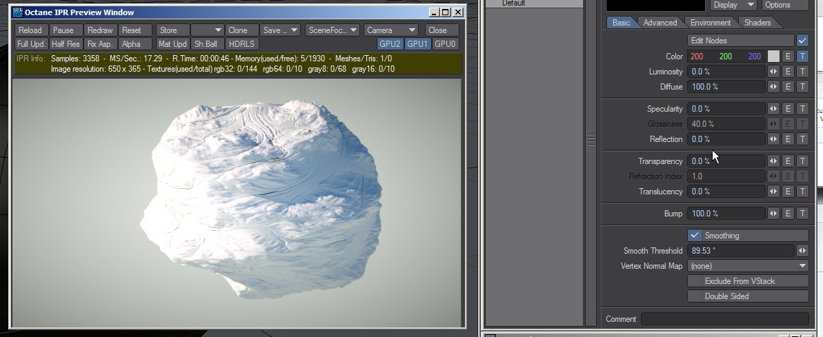

You need to enable the smoothing parameter in the Ligthwave material. Without this parameter enabled the object doesn't have the Lightwave normals and the displacement doesn't work.
