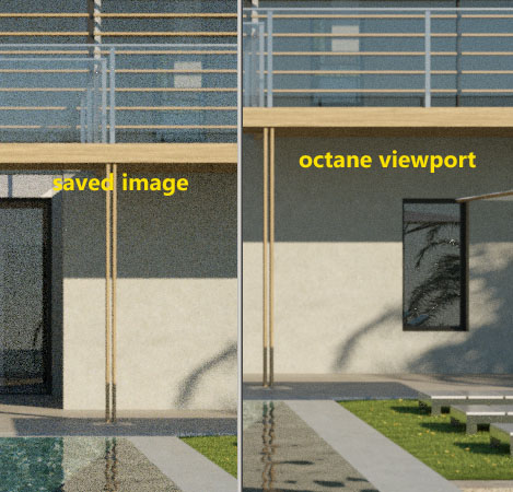

I saw in the forum that there is this problem for animation rendering.
I have same problem when saving octane viewport, saved image is not the image calculated by net render but by master.
Master is one titan, slave is 4 x titans, 3dsmaxdesign 2014
Hope it can be fixed soon, because net render is useless.

It's already fixed. It's a slave issue. See here: http://render.otoy.com/forum/viewtopic.php?f=24&t=40381

yes abstrax, but it don't solve the 3dsmax issue ?? or I miis something ??

HHbomb wrote:yes abstrax, but it don't solve the 3dsmax issue ?? or I miis something ??
It's not an issue on the master side, but on the slave side. And the slave comes from the Standalone archive (hence the link).

ooookkkkey.... works fine now, thanks !!! :-)
