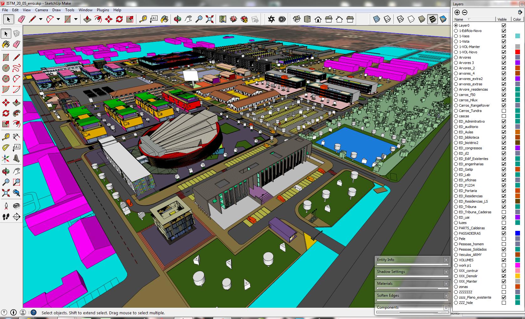

1. I organize my models into many groups and components, but when i export the models i get this with many instances, is there a way to organize it with just materials where the whole model is export as 1 obj file? (pls see screenshot)
organization
organization

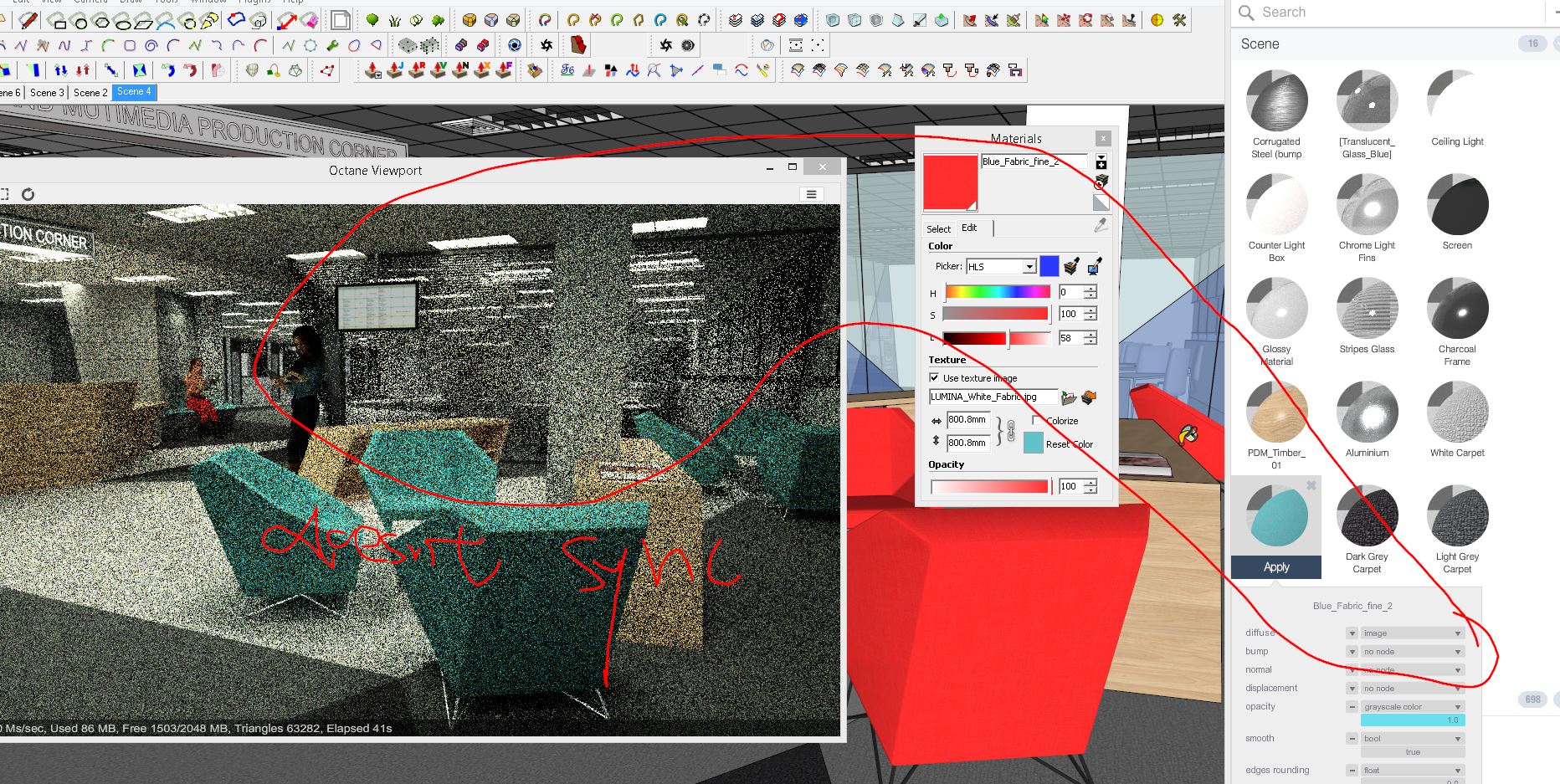

2. geometries/materials often dont sync up with octane viewport after hide/unhide, cut/paste several times
3. material with texture does not sync up with octane viewport when i change rgb/hsl values within sketchup's material editor.

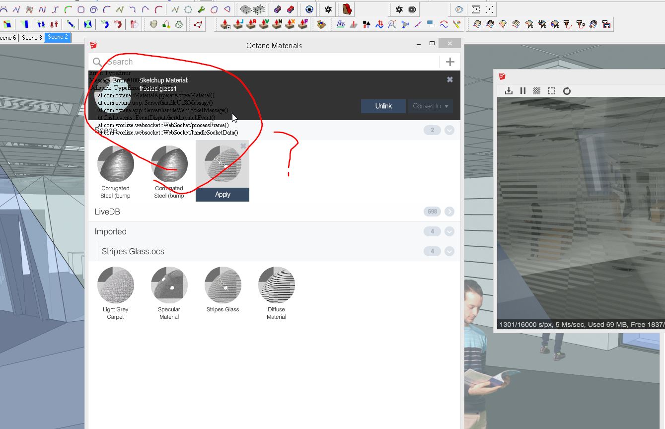

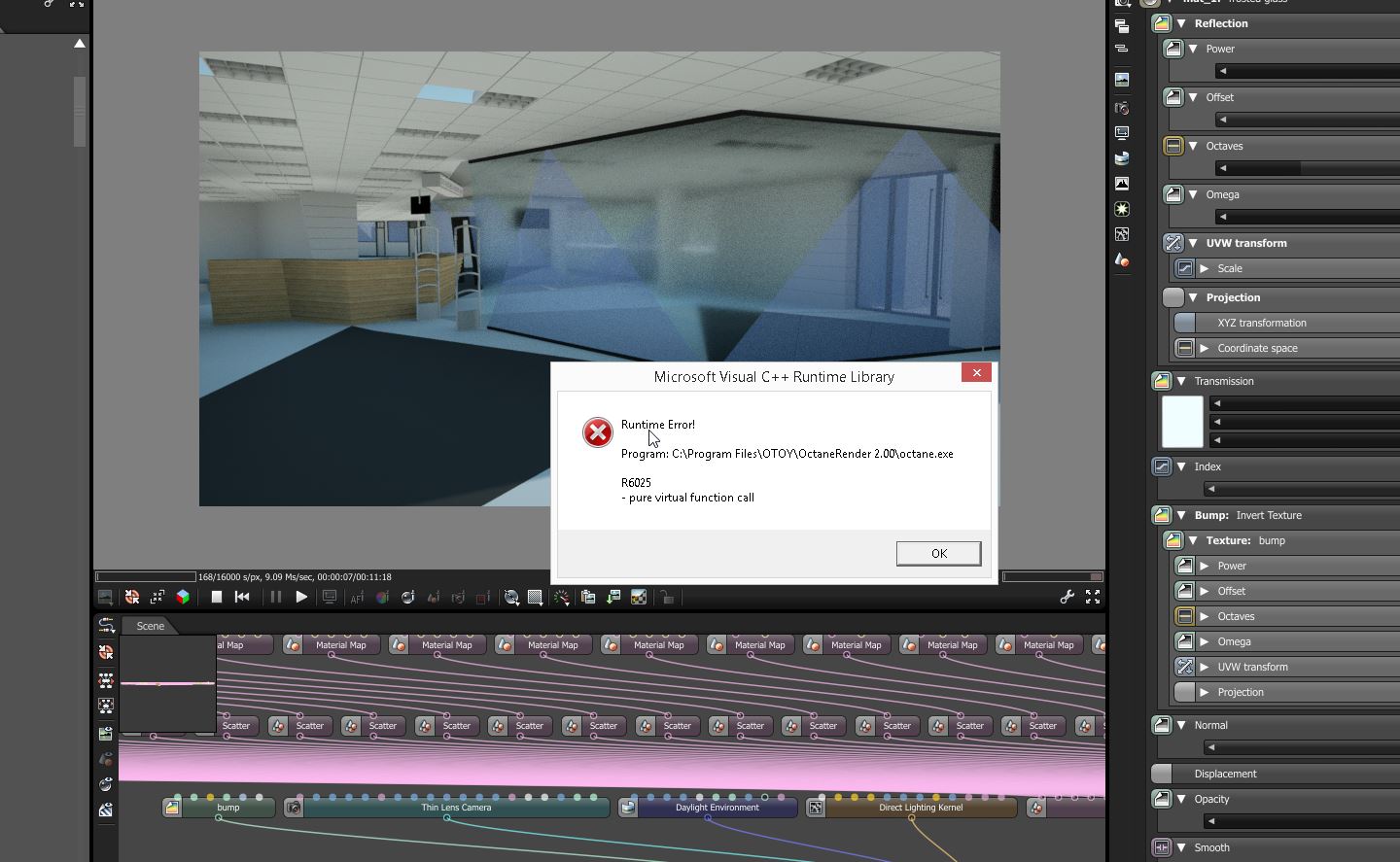

4. stability issue, both sketchup and octane 2.0 crashes way more often compared to version 1.2(where i am coming from) see screenshot. Also sketchup seem to run much slower with the octane viewport active sometimes
organization
organization
bug1
bug1
5. Material editor for octane within sketchup is a pain to use (text too small, parameters missing), I understand that it is said that octane standalone is a compliment and i am suppose to edit materials there but isn't now i have to go back and forth between sketchup and octane render, which defeats the purpose of the plugin of not having to go back and forth.

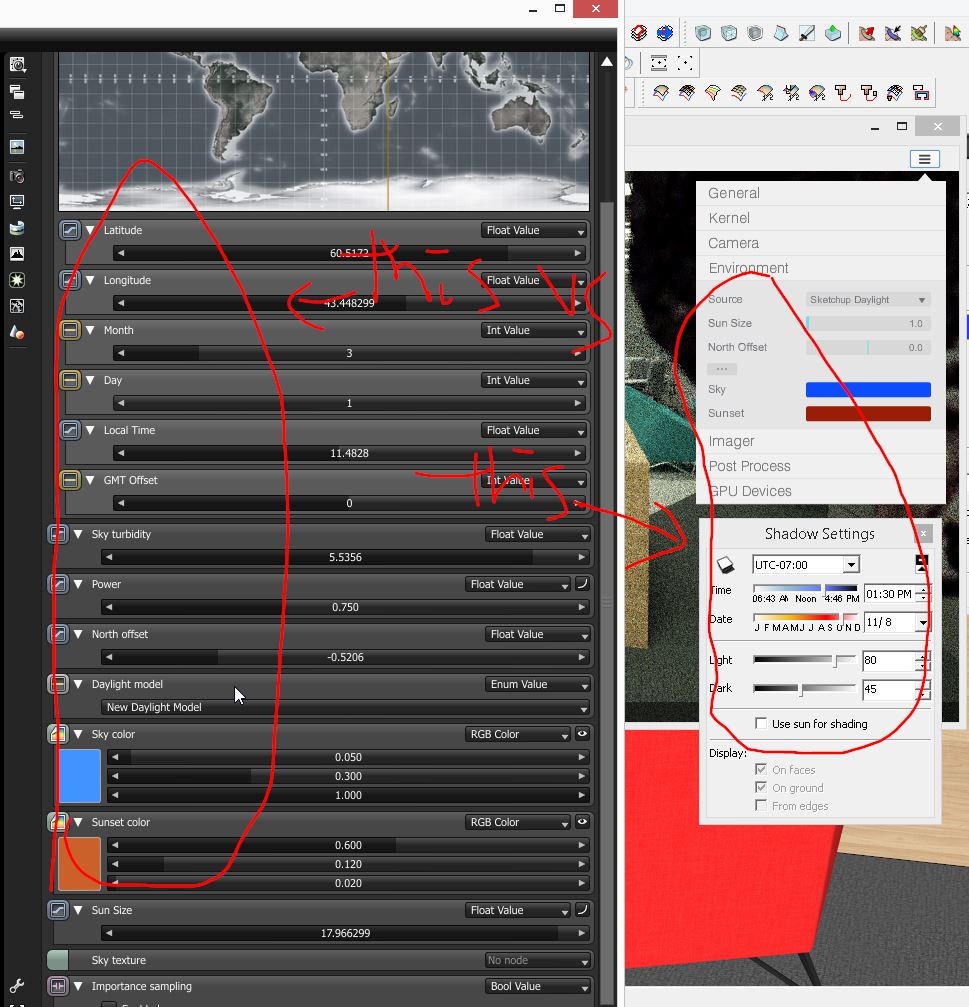

6. Cannot use octane sun with the plugin? it's very hard to tweak the sun's position with sketchup or the plugin (no turbidity, latitude...etc). I consider sun position one of the most important factor in tweaking my renders

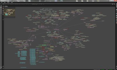

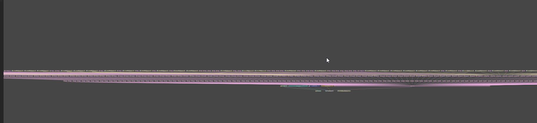

It's not a bug, it is how geometry and groups are stored inside SketchUp plugin. It might be hard to navigate when you have a lot of components so I recommend exploding geometry to a single mesh and then export it .ocs
Could you please provide test scene? I'll try to track the bug
SketchUp materials or Octane Materials? Again, test scene would be nice

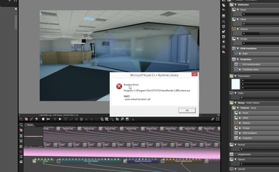

It's a first open-beta release so some issues with stability are expected. We'll track it down if you help us reproduce actions to crash it.
Octane for Sketchup is using Sketchup Shadow dialog for the sun position (day, time, offset). Turbidity and power is also available via shadows dialog.

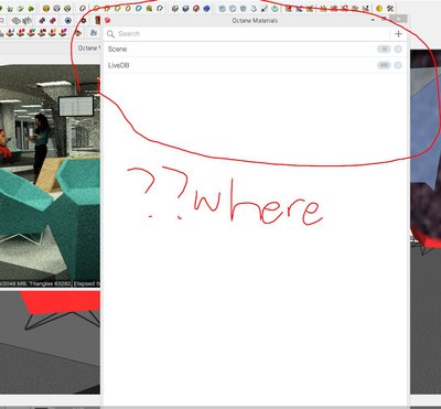

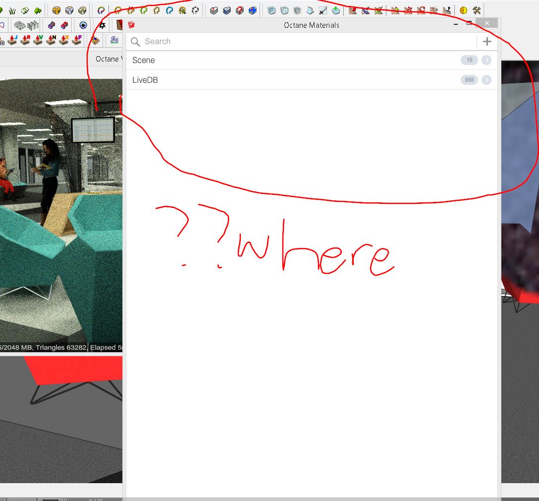

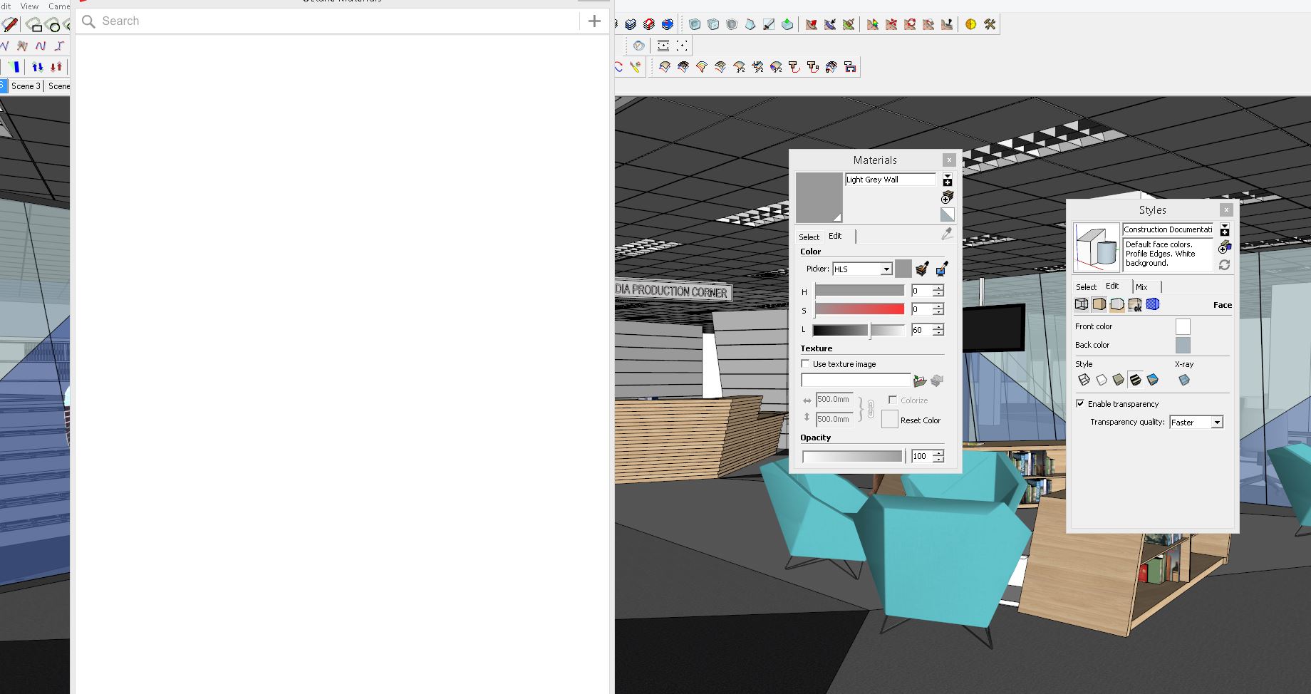

7. no localDB with the plugin?
It seemed to work. Tried on different machine and testers had no problems with it. Could you please double-check?
1. Do you mean I have explode everything in the sketchup model into a single mesh? This would not work for me as once geometries are exploded it is very hard to edit it afterwards. For now I use TIG's exporter and it worked fine and I don't need to explode the model, but then it's slow in exporting. Is there a way to export the model in similar fashion of that of TIG's exporter with the in plugin? just an exporter same as TIG's exporter but faster would be great

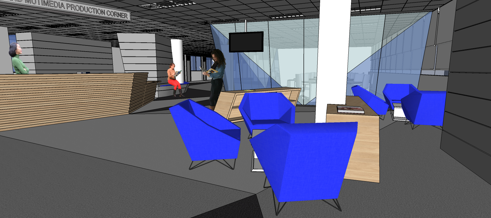

3. Octane Material. What I mean is that I cannot adjust the color of a material that has texture in it using sketchup's material editor. If you refer to the screenshot below (same model), I want to adjust the blue farbric of the chair into red, in the past with 1.2 I can just use the slider in sketchup's material editor and export octane standalone using TIG's exporter the color change shows, but now I can't seem to do that
As for the SU speed, how many GPUs do you have? Both Octane and Sketchup use GPU for rendering so that might be the cause if slowdown.
4. I have 2 GPU, 1 for octane alone and 1 for display. The scene i uploaded when i export to octane standalone using new sketchup plugin and work on it for a while it crashes 100% don't know why.

5.3 I would like to use Octane's sun/sky instead of sketchup's sun(sketchup sun is crap, to hard to control it's position..) And where is the shadow's dialog to control turbidity?
7. Where is the local DB located? is it me I just can't find it
UV mapping gets out of sync sometimes too I'll post the scene and screenshot in the next post.
Yup. But you can Ctrl-Z explosion or save scene before being exploded.
Resmas already covered that (thanks man :) ). "Update Texture" context menu is available when you select some geometry with the material and right-click on it "OctaneMaterial -> Update SketchUp texture".
Yeah, agree with you on that. But SU plugin was build for Sketchup users in the first place with a goal to introduce as few new controls as possible. Turbidity is "Dark" control of the shadow settings.
What do you mean by Local DB?
LiveDB materials that have been downloaded won't take any time to download next time when you click "Download" button.
I was hoping for something similar in octane standalone where materials can be saved for the next project/sketchup file.

oscartung wrote:Thank you everyone very much for the response to my questions, my response are as follows.
Ack layers...I thought sketchup I can just forget about layers and use groups and components instead, but I still don't understand the point of putting it in different layers. FYI I never use sketchup for 'large project', I always break a large project into smaller scene, try working on a sketchup project file over 200mb or use layout with over 20 pages and you will be up for a very painful experience.
My main concern is a solution to edit material, lights, and environment conveniently and in an organized fashion since I spent 90% of the time doing just that in rendering stage. I want to be able to adjust ies look, light power, material color and mapping, gamma, sun position size....comfortably. Apparently now I am faced with problems like too many pull down menus/expand-collaspe, material don't sync up if I use the plugin alone for the render.
I will be very interested to hear how you edit and fine-tune your materials for your scene. Thank you for your time
Oscar
Hello again mate, I have downloaded your scene and tested a bit.
Well as I said, for example in your scene I would put furniture in 1 layer, building in another and decoration in a 3rth layer, then it would be easier to model/adjust/tweak everything.
One question, do you want to work/render final images inside Sketchup or you want to teak everything in SU and then save to .OCS and render in StandAlone?
Lets take this project as an exemple :
Option 1: (modeling/exporting as obj)
if you export everything as .obj (with TIG exporter) you have a .obj node with more then 50 materials. Then in StandAlone you would teak all of them. If any change in need in the model you go back to SU, edit and export again the .obj and refresh.
Option 2: (modeling/exporting as obj, Diferent Parts)
You export diferent parts (selections) of your project and then use a Group node in StandAlone to join them. When you have to change something you go to SU edit that object and them export as .obj the part you edited. Then refresh.
Option 3 (with plugin)
You do everything inside SU, use Octane Plugin to edit materials, lights, everything. Render Final images inside SU. If you want you save all project to .OCS format and open it in StandAlone. (a big mess of nodes) but everything you did in SU is there, all materilas, light, etc etc are there (that is amazing)
Now the question here is....would be great to have the otion to export to .ocs as a single mesh? YES (and I belive Fuzzy will find a way to give us that amazing option "save to .ocs exploded" :twisted: , but for now this is what we have with the limitations of Sketchup memory.
Another thing that maybe Fuzzy manage to do is "Save to .OCS without geometry" and all settings , all materials, would be saved to .OCS and then we just need to export the scene as .Obj and load it in Standalone.
But all this option are only valid if you really need to go to StandAlone (for now... we do need because we miss some features)
To solve the problem of messy number of nodes (that plugin needs to do to save memory and fight the 32bit limitation of Sketchup), you can do a few things.
Export to .OCS - open StandAlone, erase all mesh, material and scatter nodes, and keep the material, camera, kernel, etc etc - save
In SU export project as .OBJ - load the .OBJ file and connect materials.
If you name your materials you easily set your project up and running in StyandAlone. 10 minuts max and its done you converted a big project(all edited with Octane magic) from SU to StandAlone without explode anything
Layer are as much important as groups and components.
All modeling was made in SU, and belive this is big...really big.
All was exported by parts/layers to OctaneStandAlone and in the end it was also a mess (but it was my fault rushing things and dint have the time to organize the nodes :mrgreen: )
I think its all about keep things organized and plan what we will do next...
cheers
