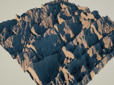

Trying out displacement mapping in 3dsmax 2013 I noticed some strange artifacts perhaps?

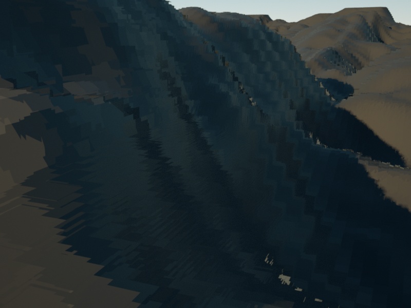

1) When zoomed very close in you can see strange stacks of polygons rather than a smooth interpolated surface. Maybe this is a limitation of the method used?

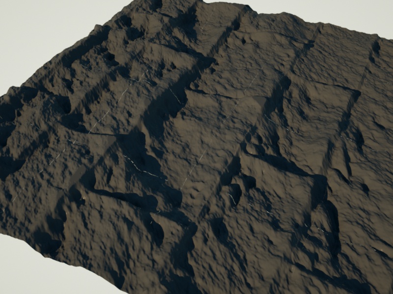

2) I get strange cracks on a simple displacement mapped plane. At first I thought it was the UV's causing repeating and some sort of UV border wrap issue but as it's just a default 3dsmax plane the UV's shouldn't be repeating so I don't think it's that?

1) This is a limitation.cybernoid wrote:Trying out displacement mapping in 3dsmax 2013 I noticed some strange artifacts perhaps?

2) Is original surface smooth?
I actually just created a default plane primitive in 3dsmax and stuck a material with displacement map on it. I will double check if there is different behaviour depending on whether it is subdivided or not and whether the number of subdivisions effect it.

Yes it seems the cracks coincide with the plane subdivisions - by default it was set to 4 in each direction. I increased the subdivisions in the attached render and the cracks moved with it.
I tried dropping an edit poly on top of the plane and screwing with smoothing groups but that didn't seem to do anything.
My scene scale/units in 3dsmax are all set to metres.
