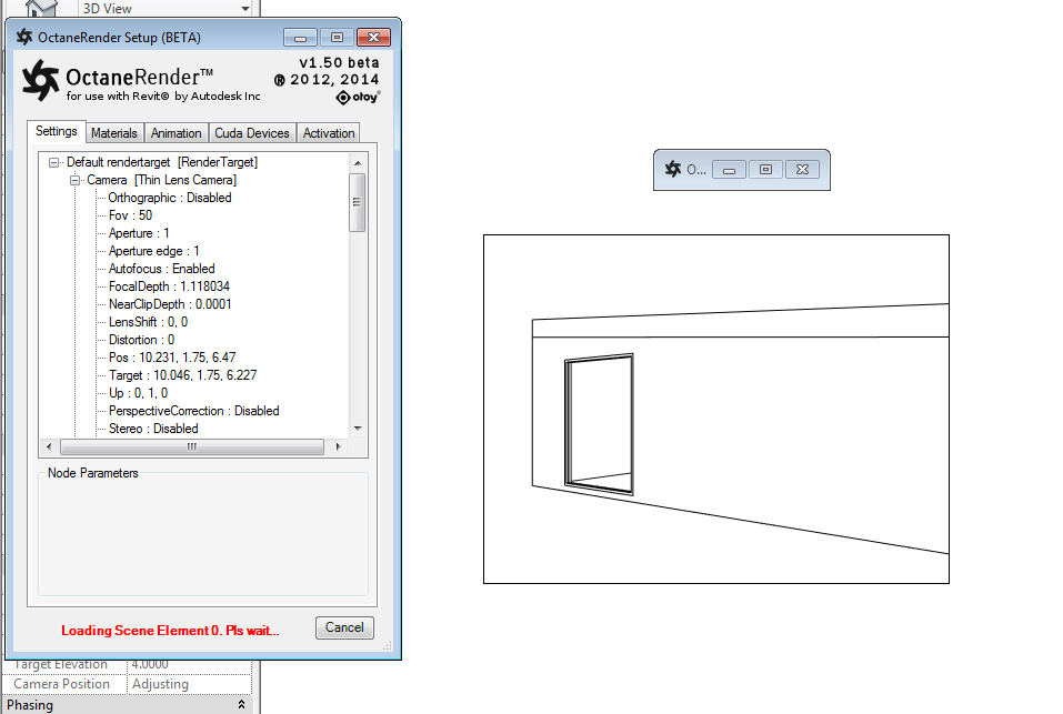

Just trying out the plugin for Revit.
When I "Open viewport" the OctaneRender Setup window displays "loading scene element 0", and the render window won't open normal, only minimized.
Does anyone know what I do wrong?
I think for some reason your preferences have saved with a Viewport size of 0,0. Try opening the Viewport with Lock Resolution clicked , and manually set a resolution of 100 x 100. Then open the Viewport.
Pls let me know if that does not solve your problem.
Paul
