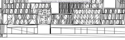

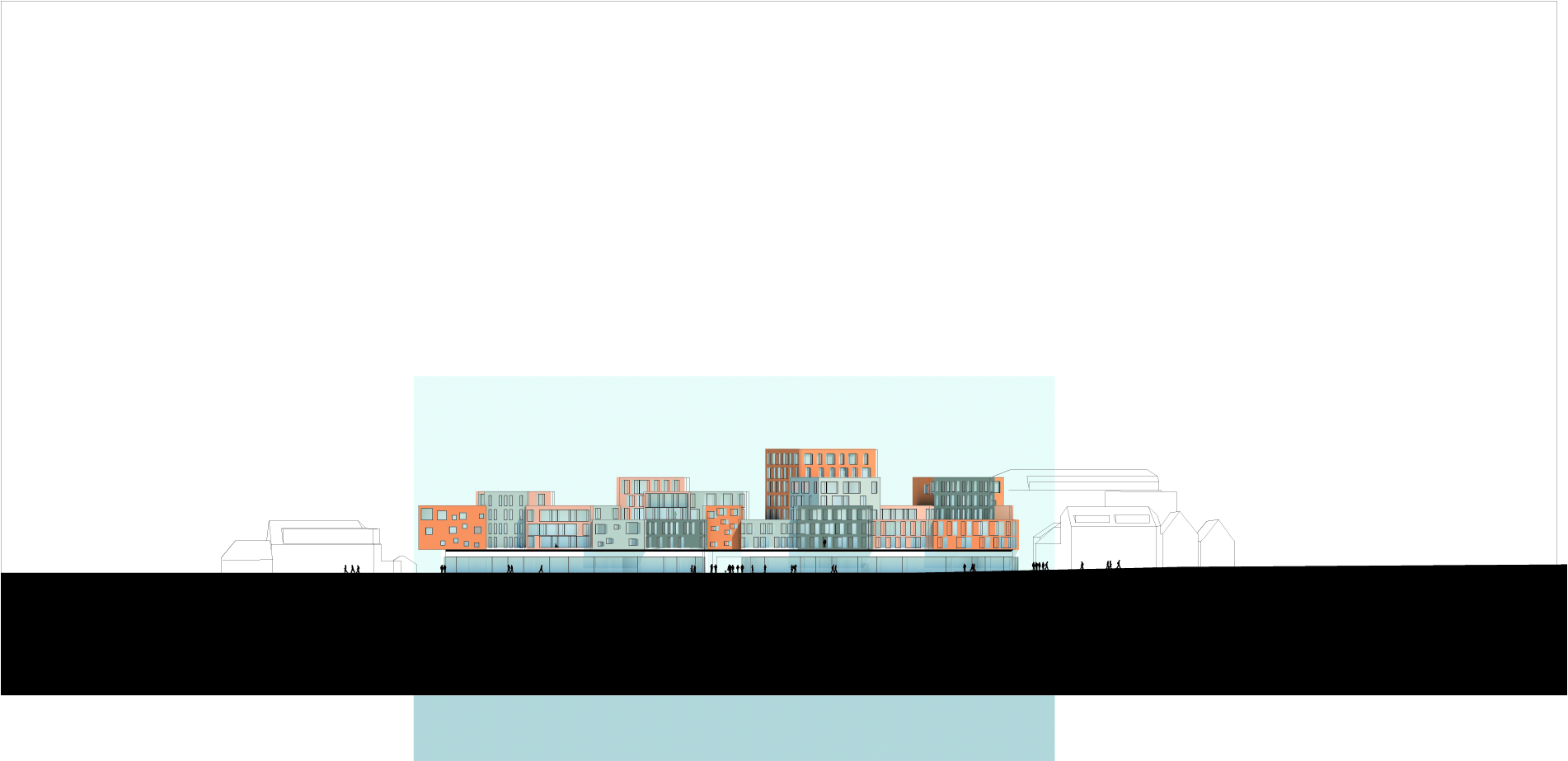

I have added some screens to show what I try to achieve.
I have also tried the Info channel / Wireframe, but I seems to triangulate all faces :-/
Does anyone know how to create this kind of illustration?
Thanks :-)

Dont use Octane camera, but a regular max camera to render. Use VRAY to render the wireframe overlay, you can use the same camera for both renderings and it takes a mere few seconds to set up the wireframe rendering in VRAY.

You can use Scanline with a standard material. Set the diffuse color to white, and use the wire feature in the material. Render and use multiply layer mode in PS.
