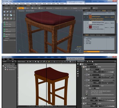

Hello everyone, I need some help :)
I want to use a chair model from modo content library
but when I export to octane the texture won't show
I already add the texture but only the color not the texture
this problem only happen when I use mesh from modo content library
if I used from my 3d model there is no problem
please help to solve the problem
thanks you :D
(sorry for bad english)
Regards
Tony

It's probably because the texture or the path to the textures includes spaces. This seems to break the Octane .obj parser.
Check the file names for the textures.

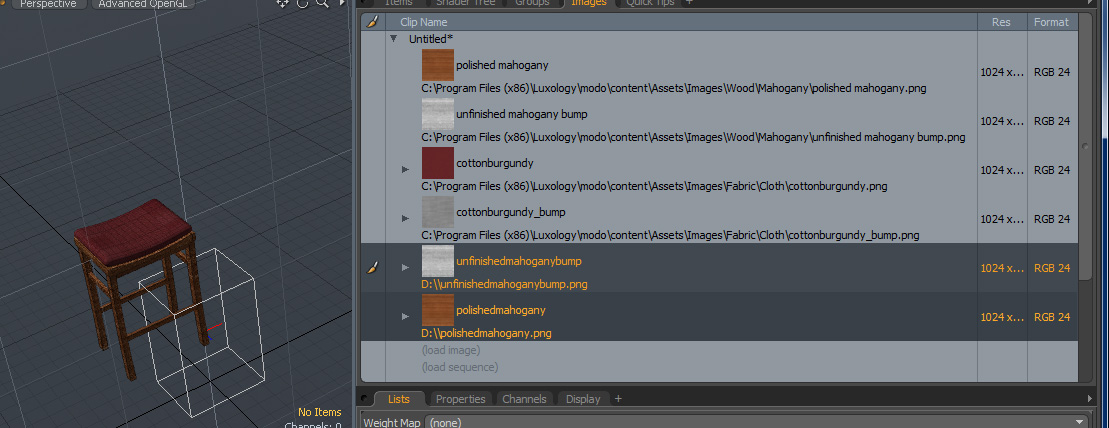

tonycho
Posts: 391
Joined: Mon Jun 07, 2010 3:03 am
Location: Surabaya - Indonesia
Hi Timbarnes
I already change the image map to D:\\
but the map won't show at octane
(look at the picture chair 2.jpg)
do you have any suggestion?
many thanks

Try to use names without spaces, like chair2.jpg.

Make sure EVERYTHING in the model is uvmapped. If not, Modo will not export any uvmap to the obj, and the textures will not show.

The models have to be UV mapped and there is only ONE UV map supportet by .obj as far as i know.
So take the different maps and paste them all into ONE ...normally called Texture.
That should do the job.
