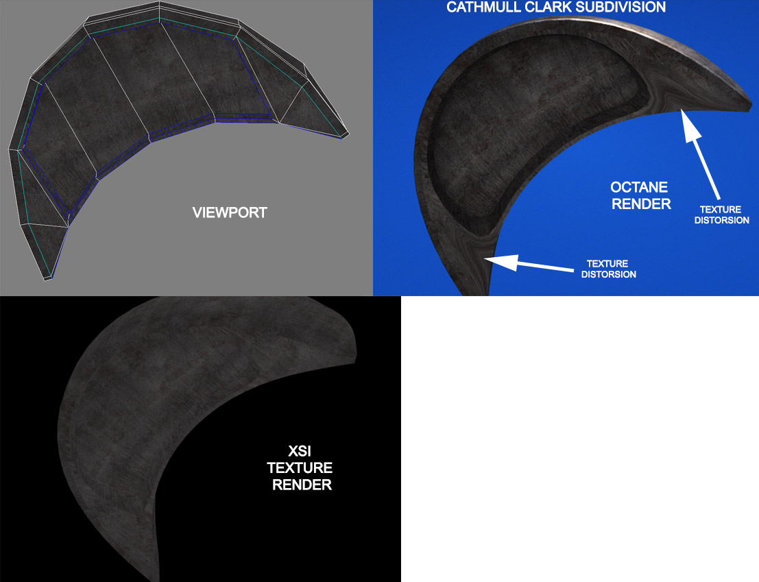

I found this strange stuff about UV
I attach to you the mesh.
Now i expalin: when i subdivide, in the viewport UV are correct, but octane do something like the image below.
Ihopw that the mesh that i attached will help you to understand. Probably if you put a checker texture you can see better what happen. Thank you!!!!!!

yashugan wrote:here is the model to look inside...Who know!
Thanks, i will take a look at the mesh.

The UV issue is fixed.
Must also fix a problem with the new material check, whith shared instance nodes.

yashugan
Posts: 64
Joined: Mon Mar 15, 2010 7:59 pm
supreme! mega cool! I'm already in production and i was already worried!You are super fast!
I wait the realease! thank you!!!
