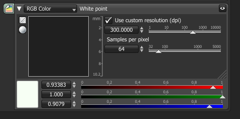

So, a client asked for a 300 dpi renders, and I don´t know how to produce that depth. Where is the setting to change de dpi of the final render, if it exists?
I tried to set a custom dpi setting in the white point, as you see in the screenshot, but it still produces a standard 72 dpi image.

Would that be the procedure? So, what is that dpi setting in the Octane preferences good for? I must be missing something.
