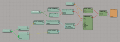

The Octane value shaders are made if you want to share some values between the shaders, like the image below.
Vectors can only used as input in single transformations shaders which are Octane_Rotation, Octane_Translation or Octane_Scale.
1D, 2D or 3D means the number of values. 1D shared his one value to x, y and z. 2D his two values to x and y, and 3D his three values also to x, y and z.
