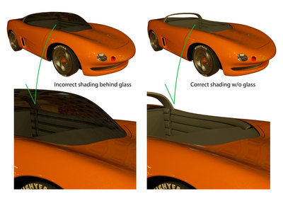

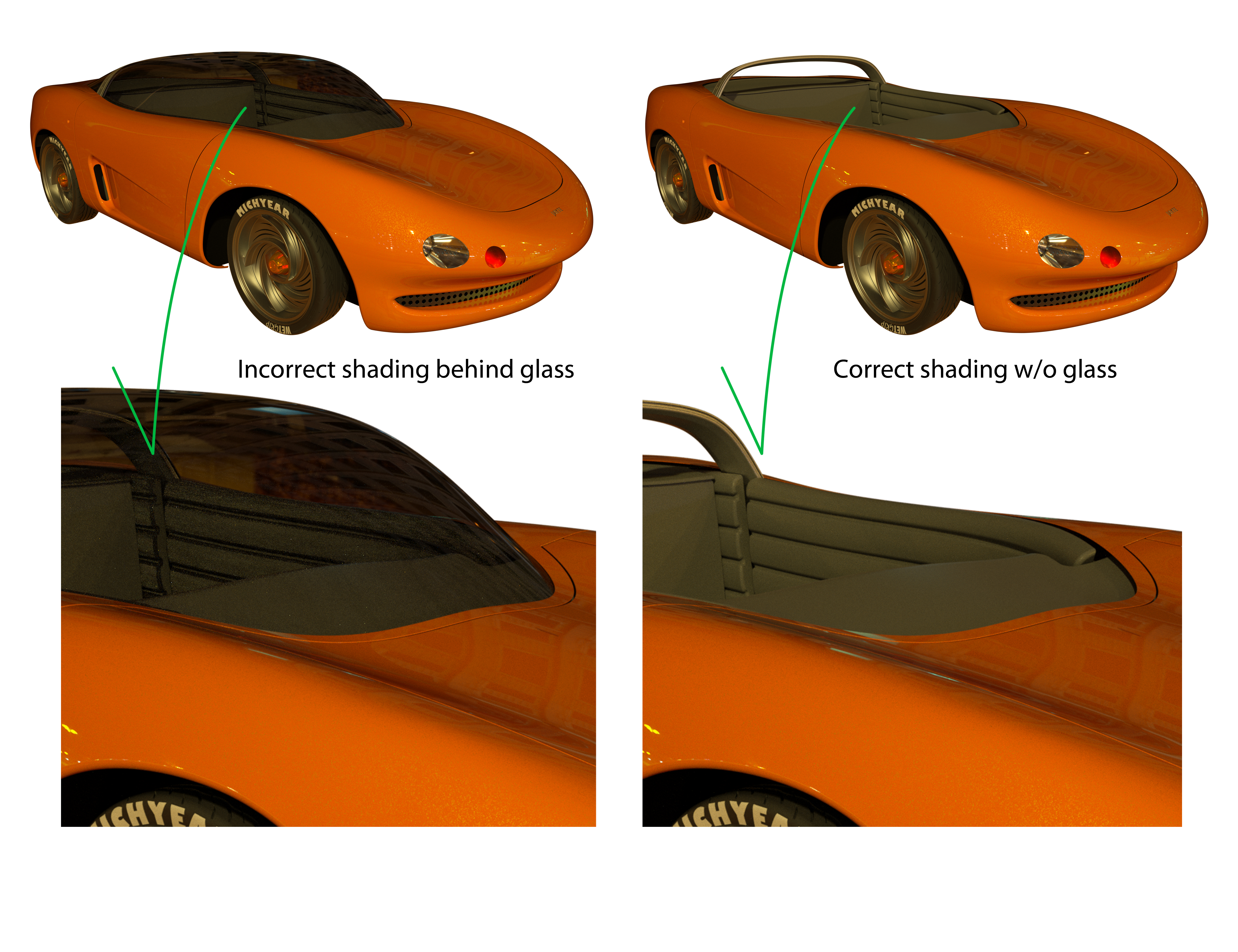

Here is an example of what looks like an Octane shading bug, or me making an incorrect PMC setting or something. Notice how the light is behaving differently on the surfaces when they are behind glass (no dispersion in this example), and when there is no intervening glass. The version on the left (w glass) is messed up. The highlights are reversed out...going dark when they should be going light as they face the light source. The image on the right (wo glass) is perfect.
The normals of both the car interior parts and the glass are facing in the correct directions.

Notice that the gray plastic areas on the far left not cast over by rays coming from the two glass pieces have correct reflections.
But there are two areas where the reflections are messed up:
1. When viewing the gray surfaces THROUGH the glass.
2. Those gray surfaces NOT seen through the glass, but BELOW the glass pieces. In other words, these areas are still interacting with the glass, even though the glass itself is not between the viewer and the gray parts.
Happens when Fake Shadows is on or off, PT or PMC. Max Depth of 32 has no effect.
Thanks for taking a look!
