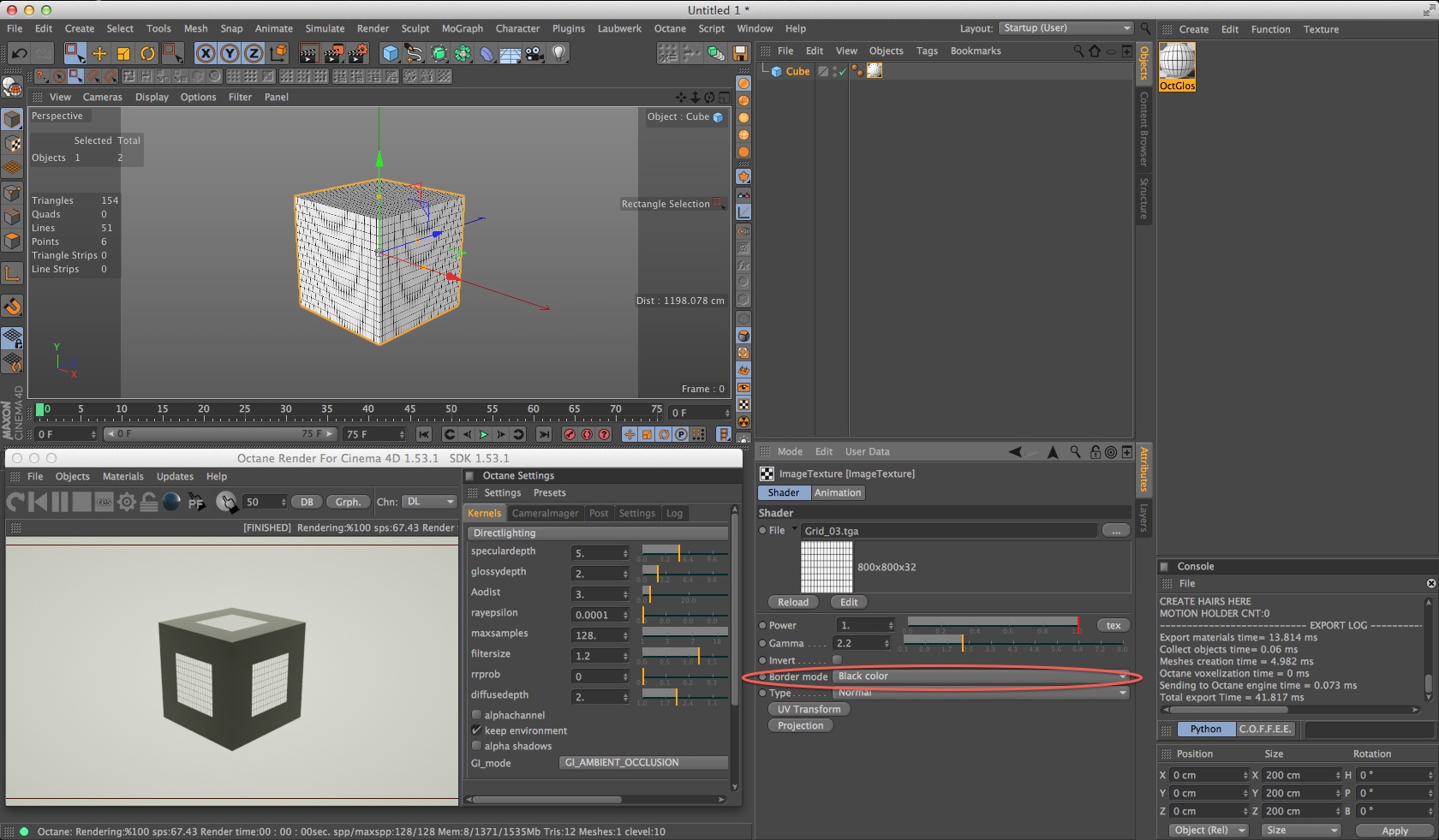

hi,
you need to properly set the "border mode" parameter in the octane image texture node:
ciao beppe
