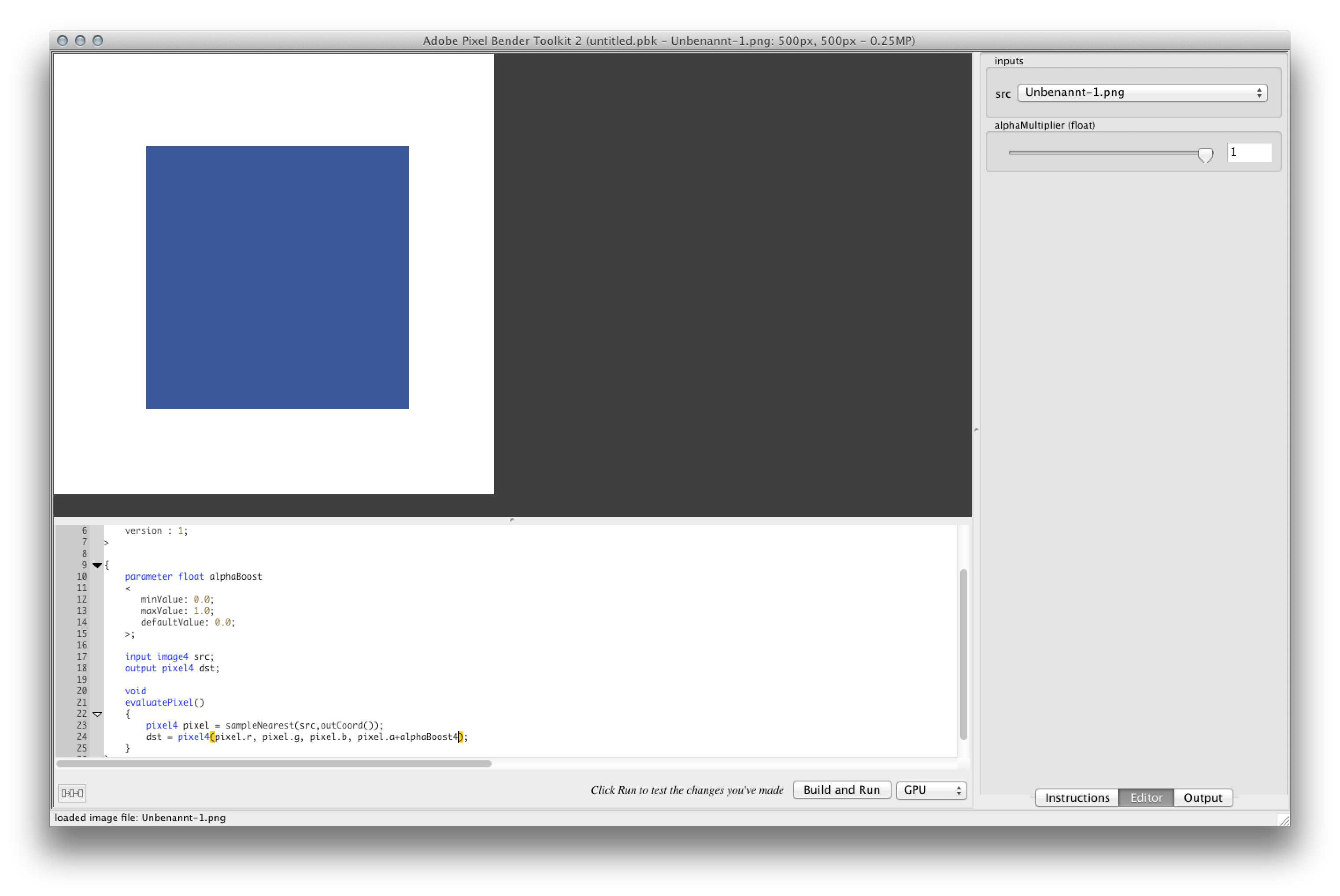

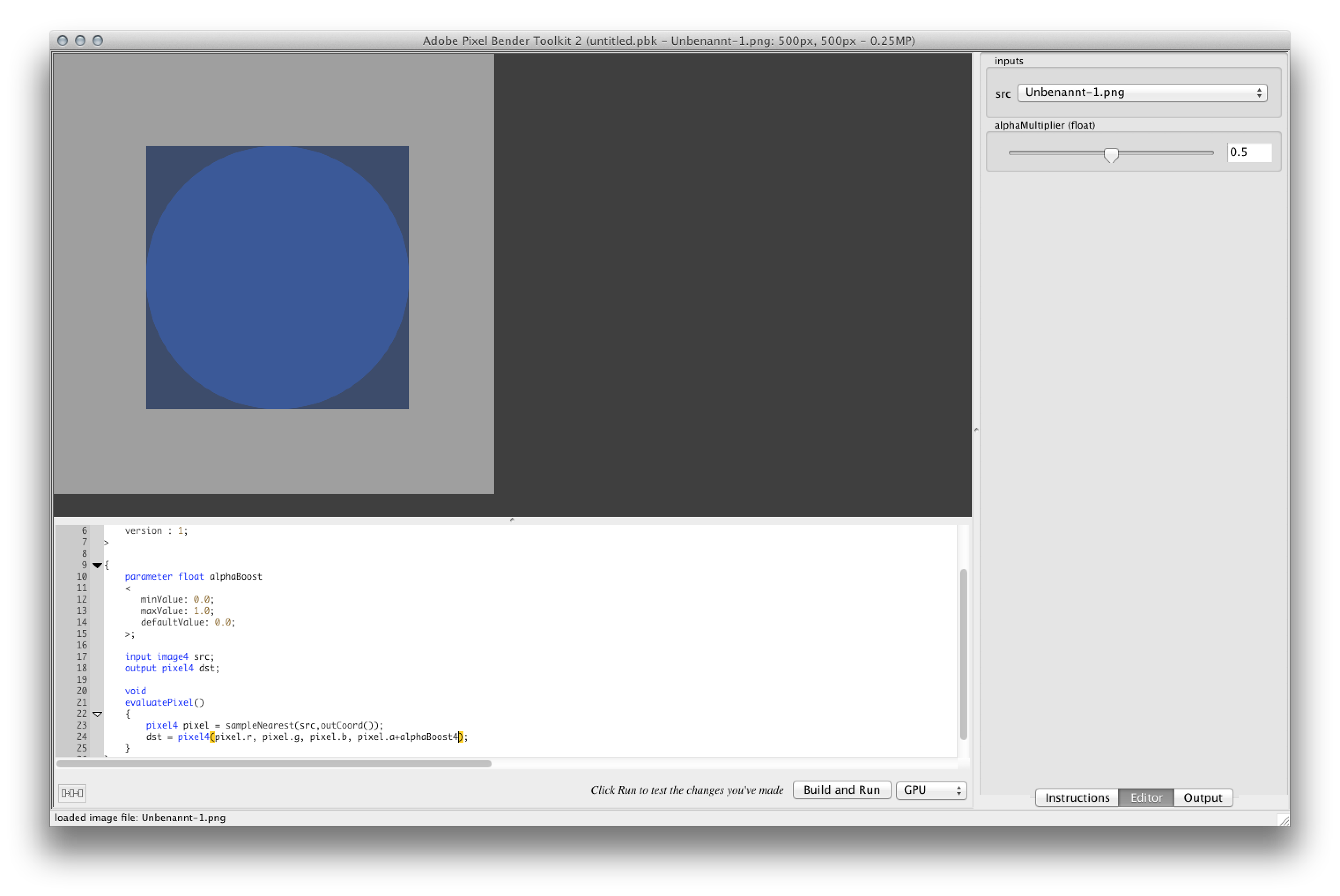

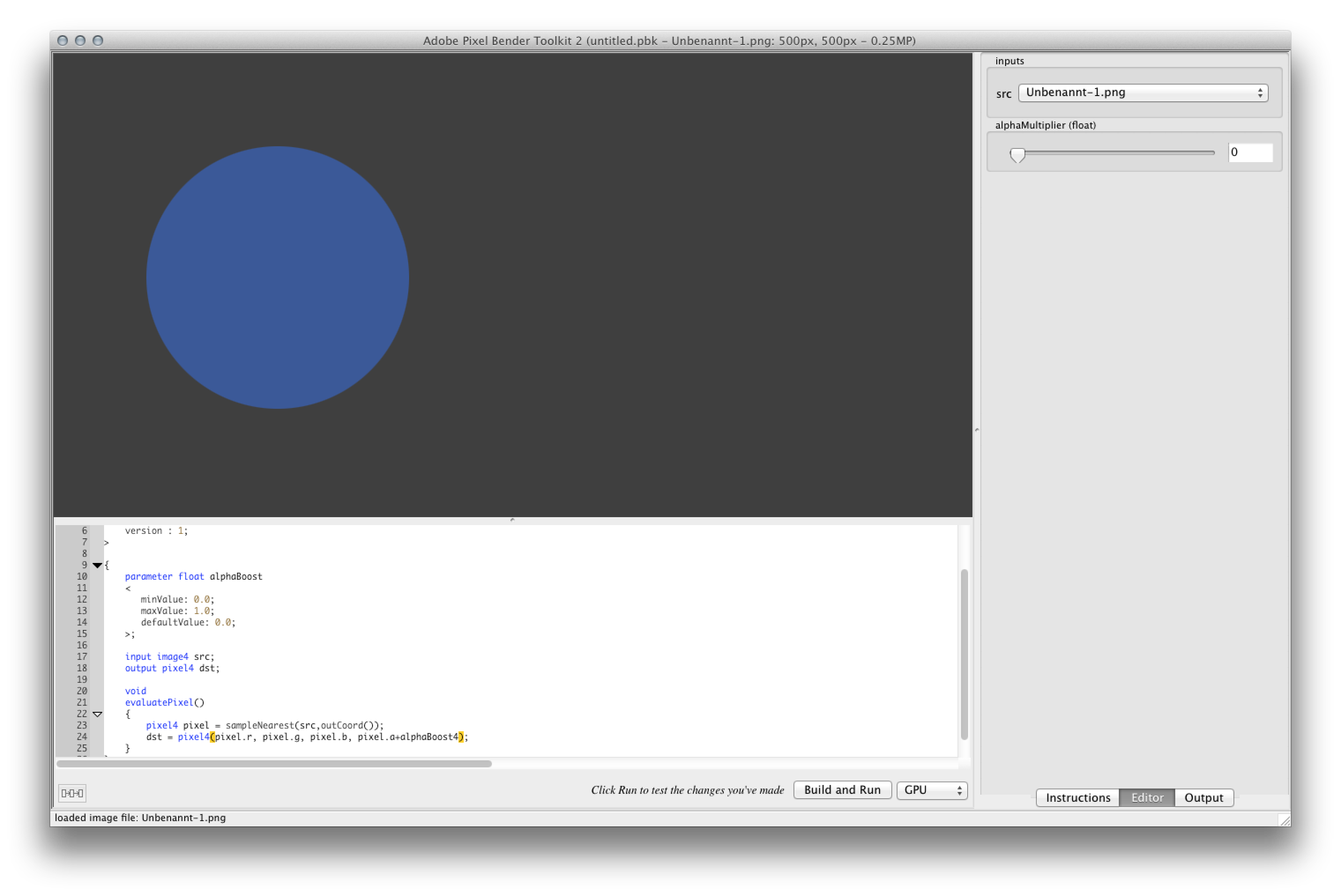

I think it's because all transparent pixel still got full rbg data (if alpha is not premultiplied). Meaning if you have a red Pixel with [255, 0, 0, 0] color data you just need to convert this Pixel to [255, 0, 0, 255] to make it visible again. If Photoshop would still support Pixel Bender you could easily write an one row shader to make the transparent pixel data visible again. But unfortunately they killed Pixel Bender for Photoshop which is a great loss if you ask me.
I did a fast Pixel bender test. Here you'll see the magic:
Original Transparency

Boost every Pixel alpha 50% (there is no Pixel with less than 50% transparency). You can already see that there's a blue Square Hidden behind the transparent Pixel

Boost every Pixel 100% (there is no transparent Pixel left). The Original Picture without alpha is revealed: A Blue square on white background.
