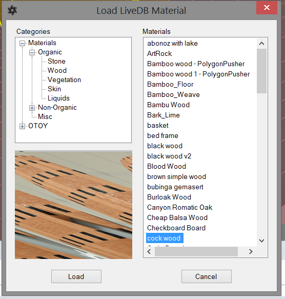

Anyone knows why my material preview is ruined?

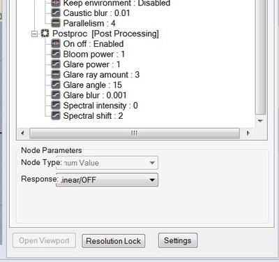

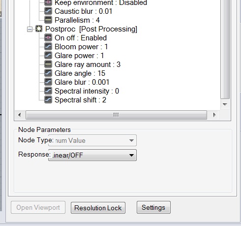

The material preview windows is garbled because the Rhino 3D plugin does not account for the Window text size being set to something other that 100%. It also causes the UI to be laid out incorrectly, and the response curve popup is unreadable because it is too narrow.
right-click on desktop ->Personalize ->Display ->Medium (125%)
broken layout with 125% text size
Fixed in the next release.
