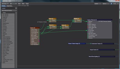

there is an issue with the camera aperture working in inversed mode as expected in a real camera. a low aperture number like 0.8 should result in a very shallow DOF, whereas a number like 16 should result in a very deep area in focus.

octane is opposite, yes.
You want this, though, as it will allow you to use the lw camera's settings to control both renderers' camera:
I did not create this file and I am remiss in not knowing the gentleman's name. However, the original post is on this site.

thanks for the tip!
