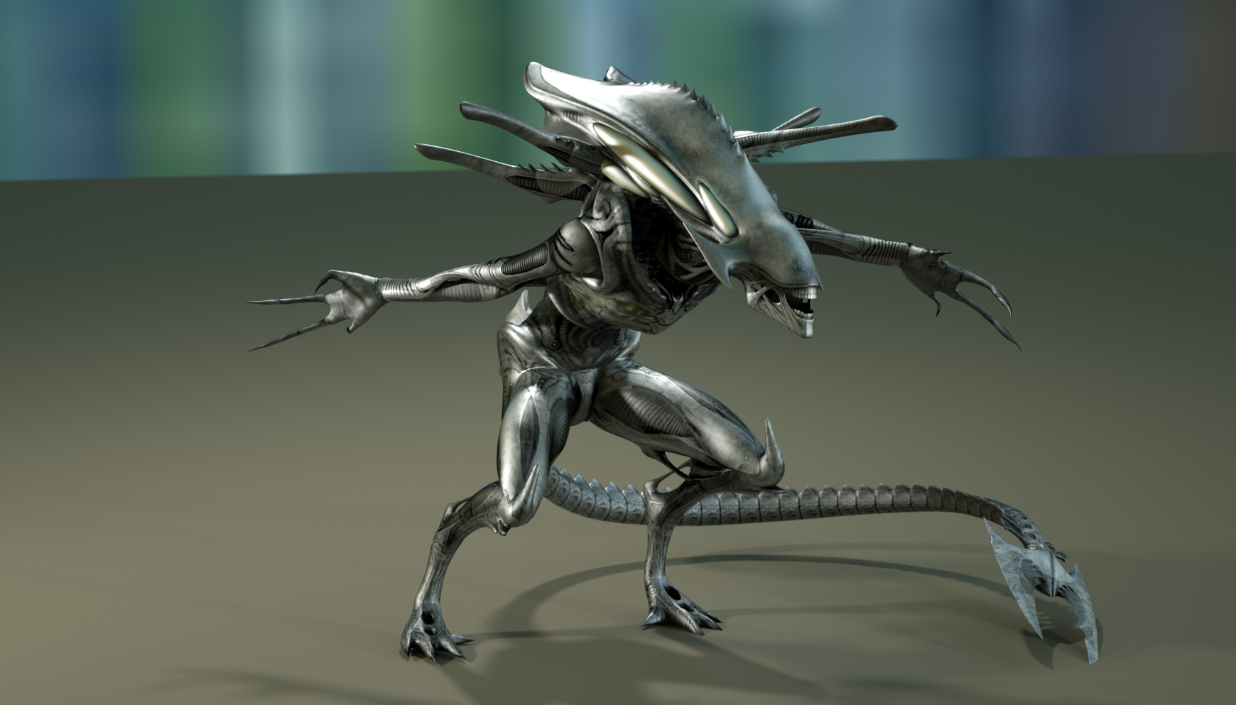

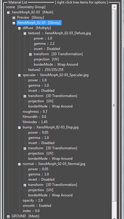

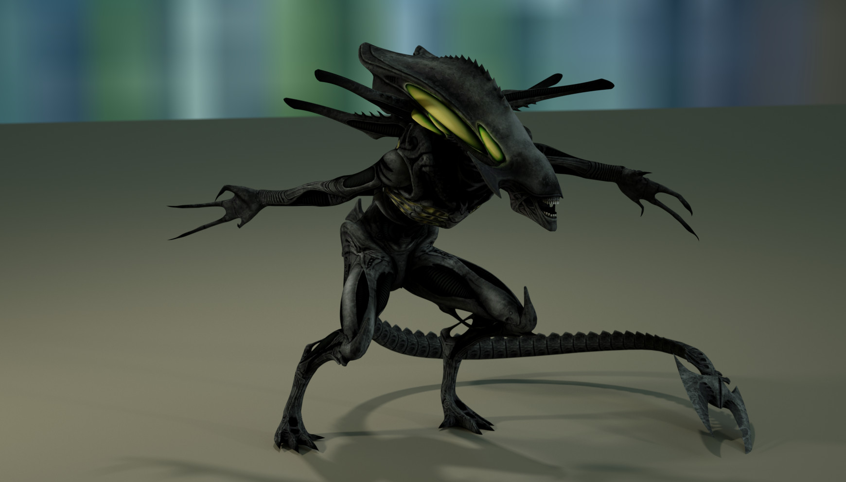

Trying to get the materials right for this model.
Octane imports it Glossy by default but as you can see the colors are all washed out for some reason...

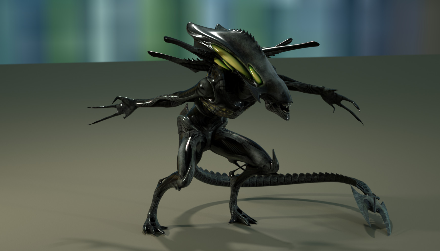

So next I tried Defuse, the colors are much better but now there is almost not reflection at all.
The third image is the effect i am going for.
I know I must be doing something wrong but have no idea what.
Any suggestions would be much appreciated

Stick with specular, but reduce the roughness to give it more defined shine (something like 0.1 maybe), set the index to about 1.4 and specular about 50%. Tweak those 3 settings to get the look you are after. Maybe add some turbulance to the bump to break things up a little.

This is alittle involved, but what I would try is a material mix. The first material getting close to the texture you want (like Paul talks about above) and the second material a type of glass so what you end up with is a perception of depth...reflections offset a bit from the texture itself, similiar to the 3rd xenomorph picture. I'm at work at the moment, but I'll do some experimenting later tonight with this.

I'd be willing to give it a shot if you can recommend some settings. One of my problem with material mix is where to plugin the image maps that come with the model. I wasn't sure which ones to use, if any. It comes with defuse, displacement, normal, reflection and specular

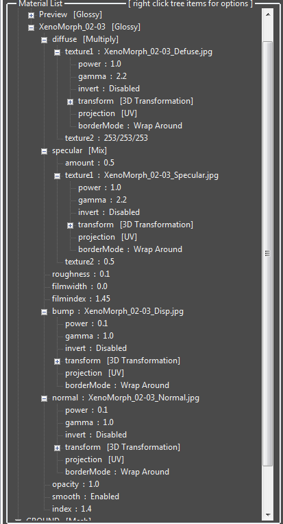

Anyway I made some changes based on Paul's recommendations and it is looking much better. Still needs a little work though.

Looks much, MUCH better! Keep at it and you'll get there...and getting there is part of the fun (and pain) of Octane! :D
Most of it is straight forward...diffuse textures plug in the diffuse channel, normal textures (greyscale) go into the normal channel and specular (also greyscale)into specular. It's possible to put the normal texture into the bump channel but bumps are RGB by nature.
You could use the reflection map, but I'd just let Octance create it's own reflections based on the lighting you're using. Displacement maps aren't supported yet ALTHO you can use them as normal maps if you didn't have any bump/normal textures.
For instance, with the plugin diffuse node, select it and choose RGB image from the pulldown in the bottom pane. From the dialog popup, select the xenomorphs diffuse texture. Same with the others. If you find yourself running low on video card resources, choose greyscale image instead of RGB..it'll still work fine.

If the Poser monster already has a bump map, then use it rather than a turbulence node.
