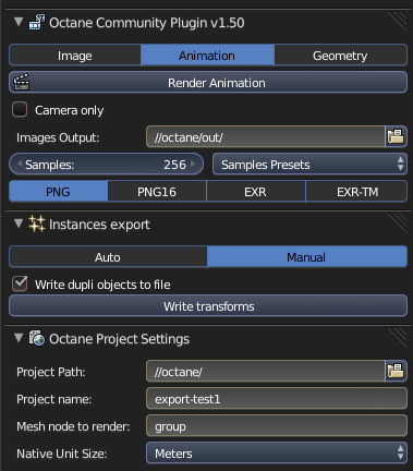

This is the unofficial Octane exporter now fixed for OCS versions 1.5 and above. I took the 1.17 exporter version (which I was using up until now), rewrote the engine module, changed the GUI a little bit and also integrated the particles exporter script, so now you can do animations with particle instances.
Major changes:
* It works with Octane OCS versions 1.5 and above (or more precisely: it wont wreck your .ocs :) )
* It automatically exports particle systems as .csv files
* "export camera only" for flyby animations
* OCS is written only if the file doesn't not exist, never edited thereafter
* Camera updating works for RenderTarget node
What doesn't work any-more (because of OCS file structural changes)
* writing stuff into an existing OCS, which would corrupt it
* the material tab is pretty much useless now (shading is done in Octane anyway)
* "create or replace OCS file" was removed
* "Write materials in OCS file" was removed
New GUI options
* Export options: Image (renders current frame still), Animation, Geometry (just exports obj/mtl, without starting Octane)
* Camera only: exports just the active camera for each frame, without geometry
* samples & preset option is added in case of stills too
* Instances export can be automatic or manual. In auto mode it exports all PS on active layers (even if emitter is hidden for rendering). "Write dupli objects to file", will export the particle visualization object to obj/mtl each frame. (you might want to disable this for animations, unless the viz object itself is animated)
* Mesh node to render: is the name of a geometry node to render inside Octane. Usually this will be some Geometry Group node, but can be any geometry node. If the name is invalid, Octane will complain, if you leave it blank it will be the name of the .obj of the scene.

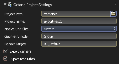

1.51 Update (download at the top of the first post)
* Speedup in exporting animations. It's now properly exporting the next frame geometry, while the current one is rendering in Octane, like the old exporter did. Which considerably speeds up animation export.
* Render targets & camera export. Besides a geometry node, you can now specify a Render Target node to render inside Octane. The current camera settings are now updated for that render target, ie. whichever camera node is connected to that RT, it gets updated via a Lua script. The Lua script file is generated on the fly for each frame.
Geometry node - name of a geometry node to render inside the .ocs. Usually its a Geometry Group type, but can be any one. If it's not specified, the .obj node name is used
Render Target - name of a RT node to render inside the .ocs. If it's specified, the geometry one is ignored. If its not specified, the geometry one is used.
Export camera - if you want to export the current Blender camera settings. If a RT is specified it will update the Camera node of that RT else it will update the "default" camera node "behind the scenes".
Export resolution - if you want to overwrite the res. setting in the RT node inside the .ocs
Get accustomed to properly name your nodes, if two have the same name, the behaviour is unknown ;)
