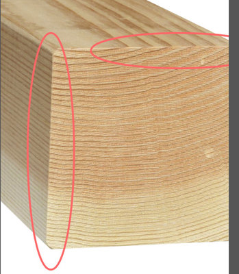

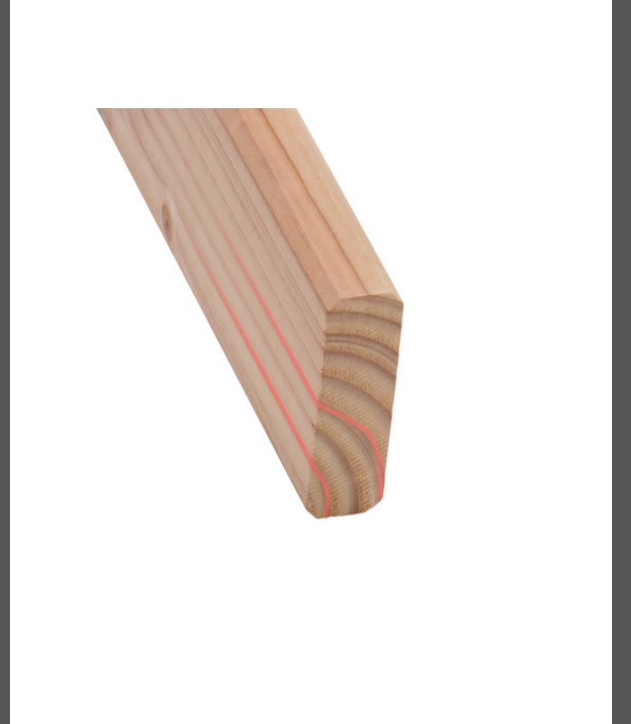

Need to make a lot of wooden stuff (timber bars, planks). Simply objects but they need to be mapped very detailed with proper tree rings along the front cut face. I used two textures so far but the don't fit.
I attached two photos where you can see the needed requirement. I have to do around 150 of those so I thought about a procedural solution.
Any ideas here?

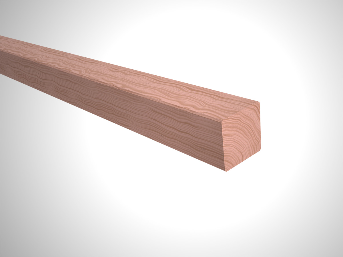

I worked on a solution last night and now use Scanline render with the "Berconmaps" (http://www.ylilammi.com/2013/09/berconmaps/) to render out a large texture for my object wit hrender to texture which works well for procedurals.
Then I switch to Octane and use the map as a material there. Not best solution, because i produce a lot of textures and it takes time for all the single steps. Also tweaking after rendering is difficult too. I also don't like the texture very much at the moment. It still looks painted to me.
