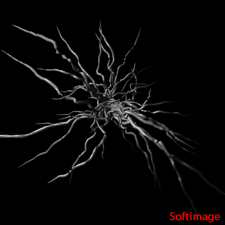

[u]Strands[/u]
Strands are now supported.
To use it, use a instand shape of your choice. The shape should be subdivided at the y axis.
The size is not 1:1 MentalRay, so that you should test it. XYZ scaling is not integrated.
Hard edges are not supported, to make a edge hard, insert a new edge, like SubD-modeling.
Some strands have a curious alignment.
For that, there is a parameter in the plugin under the "Export Configuration" tab, called "Strand Modifier".
With that you can correct them, i hope.
You should test it too, before you render a animation.
The instance shape can be animated. Shape animation not tested, should work, SRT animation works.
Particle colors are integrated too.
The technique to extrude the instance shape along the strand is not perfect, so that you can have some flipping.
But it is better then the MR one ;)
