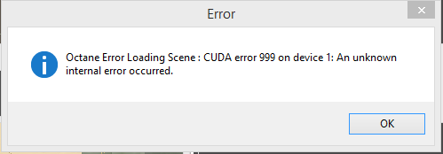

Maybe it's because I built this scene in windows 7, and now opening it windows 8.1 pro? Also, Octane can't find material I used from Live DB. UGH. Here is the log, and also attached a pic of the error 999.
Started logging on 19.04.14 16:06:30
OctaneRender version 1.50 (1500001)
File Load Error: Could not load 'C:\Program Files\Smith Micro\Poser Pro 2014\B:rgba'.
File Load Error: Could not load 'C:\Program Files\Smith Micro\Poser Pro 2014\L:rgba'.
File Load Error: Could not load 'C:\Program Files\Smith Micro\Poser Pro 2014\T:rgba'.
File Load Error: Could not load 'C:\Program Files\Smith Micro\Poser Pro 2014\H:rgba'.
CUDA error 999 on device 1: An unknown internal error occurred.
-> Failed to bind device to current thread
CUDA device 1: Failed to initialize resources
Cuda error 999 ????? Help

- cuda error 999.PNG (5.07 KiB) Viewed 11075 times

Never seen the 999 error, can't help there
But regarding the missing textures there is a solution for the future:
In the setup of the plugin there is an entry for LiveDB texture map. By default it is set to a temp folder. When you moved from one OS to the other, that temp folder got lost. What I did is to change that path to a the texture folder in one of my runtimes (in my case P5\Runtime\Textures). I created an Octane folder in textures and that is what the path is set to.
Now that folder moves with the runtime (backup and move to a new machine). As long as you keep the drive letters identical octane will be able to find it
Paul has to answer that 999 problem

OK, sounds good. Thanks. Rebuilding the scene as we speak. When done, I'll post back what the results are.

A Poser scene with Octane node will contain texturemaps from your Runtime, and from your LiveDb texturemaps folder, and potentially other sources. When you move that scene to another PC, you need to make sure that Runtime has the same path on the new PC as the old PC, and you need to copy the LiveDb texturemaps (the folder which is specified in the plugin Configuration). If you built the scene with an older version of the plug (prior to where you could specify the LiveDb texturemap folder), the LiveDb texturemaps will be in the Poser temp folder from memory. If the plugin cannot find a texturemap it will ask for a new search path.
Cuda error 999 is a card failure error I think. Reboot your PC. Make sure you have not overclocked your card, and that you are not rendering in OctaneRender for Poser AND OctaneRender Standalone at the same time.
Paul
Paul

Yea, that seems to be what happened. When I upgraded to Windows 8.1, it has a different file structure and could not find the original location. Rebuilt the scene in New setup, and so far so good. Thanks.
