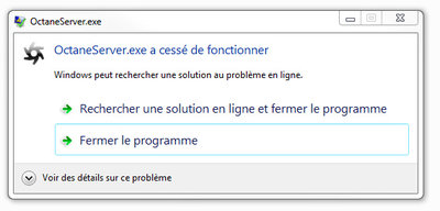

Sorry... Whatever I do : enable Render in viewport, hit render or animation button, with or without alembic box enabled... I still get immediate crash of the server with message in the console :
Octane : ERROR activate render-server.
octane : Network send error
Octane : Error resetting render server.
I typed again my logins in case it was necessary ... same result. :(
I deinstalled Blender for Octane and the server one more time. I rebooted the computer to avoid any possible residue in memory.
I installed again, without adding my personnal config folder to avoid any possible conflict with parameters entered by previous releases , Official and Octane. I haven't added any addon.
Typed again my logins and passwords...
As it is, this release still leads to immediate crash... With default scene. No need to load a personnal file. It crashes with default scene with just a cube and a camera.
:arrow: I am using the most recent Nvidia driver : 335.23. it is compatible with both my GTX 260 display card (compute model 1.3 not used for rendering) and my GTX 380 3GB (Compute model 2.0) used for rendering. In Standalone preferences, this driver is displayed as Cuda 6.00. Is it convenient for this release ?
Signature du problème :
Nom d’événement de problème: BEX64
Nom de l’application: OctaneServer.exe
Version de l’application: 0.0.0.0
Horodatage de l’application: 534e0b33
Nom du module par défaut: StackHash_1dc2
Version du module par défaut: 0.0.0.0
Horodateur du module par défaut: 00000000
Décalage de l’exception: 0000000000000000
Code de l’exception: c0000005
Données d’exception: 0000000000000008
Version du système: 6.1.7601.2.1.0.256.48
Identificateur de paramètres régionaux: 1036
Information supplémentaire n° 1: 1dc2
Information supplémentaire n° 2: 1dc22fb1de37d348f27e54dbb5278e7d
Information supplémentaire n° 3: eae3
Information supplémentaire n° 4: eae36a4b5ffb27c9d33117f4125a75c2

I see the activation error as the first error in log. Have you activated the plugin and standalone?
Is the network present when you enter the login/pass?..
It seems you are only one who has this problem, so we need to narrow down this... I've just stopped the animation render which worked all night on my work-computer on this last version - no problems at all...
Yes, both Login and password for plugin and standalone are entered. They are present in the fields when I relaunch Blender.
Yes.

JimStar
Posts: 3845
ROUBAL wrote:Yes, both Login and password for plugin and standalone are entered. They are present in the fields when I relaunch Blender.
They should be present in the fields before you start render. Is it the case?
If yes - check if the file ".octlic" is present in your user-folder (e.g. "C:\Users\<User name>\.octlic").
ROUBAL
Posts: 2199
Location: FRANCE
YES.
YES, the .octlic file is present.
EDIT : After many attempts at random, I discovered one thing :
If I first Open Blender and launch the server, or If I launch the server and open Blender in a second time, the first attempt of rendering or exporting an alembic or opening the render preview gives a server crash each time.
I can do it again and again an always get a crash.
:arrow: NOW, if I don't close Blender after a server crash and relaunch the Octane server, The server doesn't crash next time I hit render or animation or open the render viewport. :!:
I have been able to launch several times the render of one image and of a serie of 10 frames as well as render preview and alembic on an animated cube on 10 frames.
I have to test on a real complex scene.
