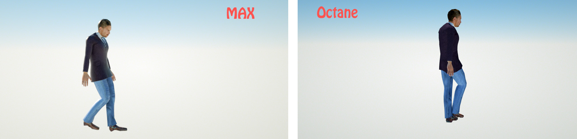

I just did a controlled test of a scene set up the same way in Max and Octane, same model, same lighting, etc, and the results were a bit less dramatic than I've previously seen, but still pretty significant:
49 sec for Octane, 170 sec for Max to render 128 frames with one model and one light.
I've attached comparison shots.

Materials don't look the same. I see glossy reflection in max version and don't in standalone.thenomad wrote:I think I'm using the standard Max framebuffer - how would I change them over?

3dsmax frame buffer is not so fast to render 2 frames per second. So if you need to render lowpoly model in the middle of nowhere, standalone probably will be better.
