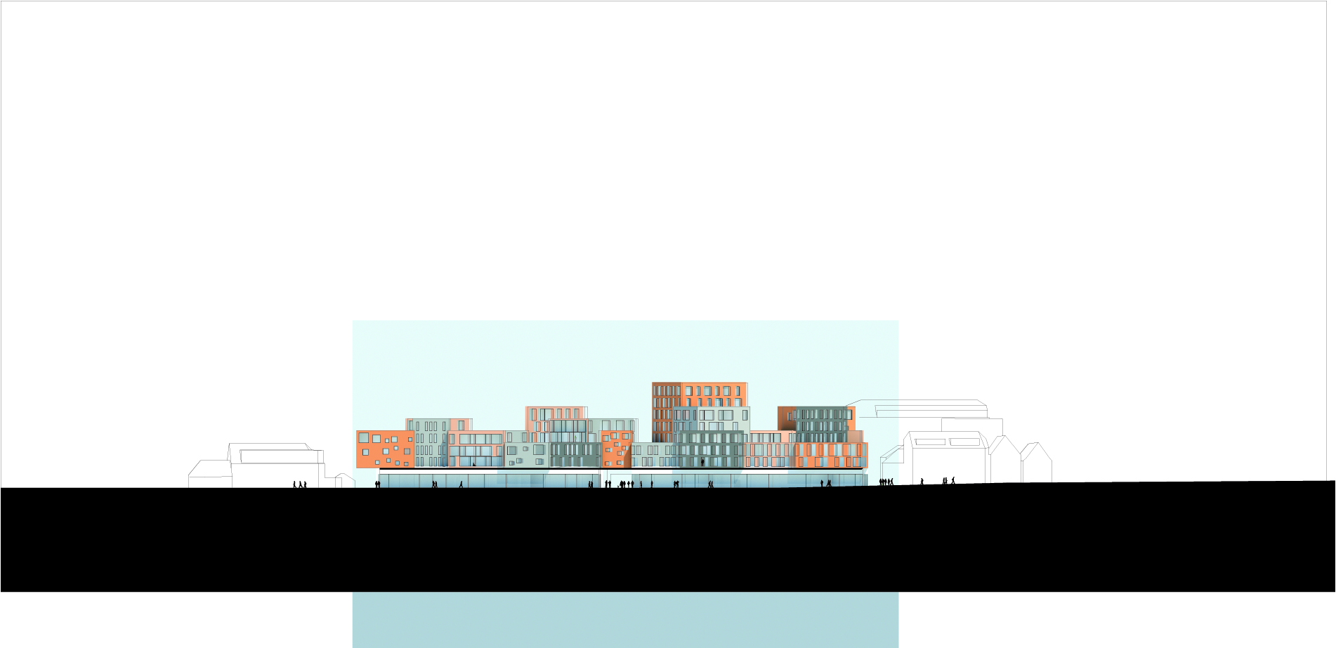

I'm trying to create an illustration where there is a render background, with lines on top.
As you can see in attachment 4.jpg I'm struggling to fit line and render. In 4.jpg I have exported the from Revit as DWG. Rendered the facades in 3ds max (trying to find the right view), and then merged the two in illustrator.

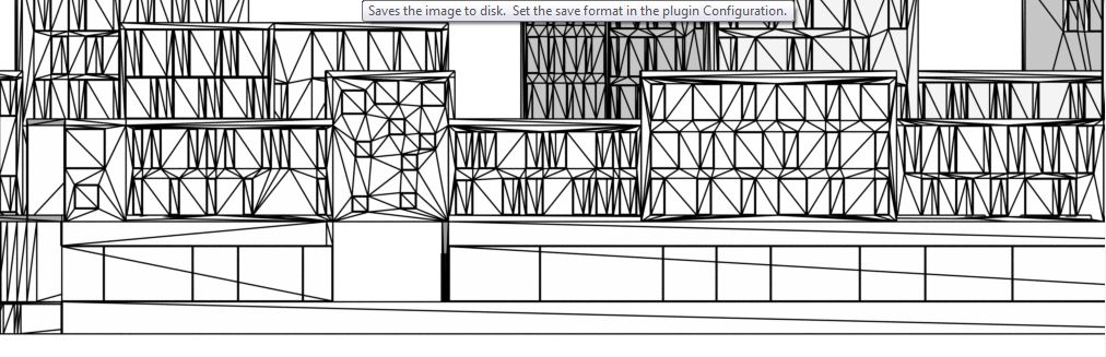

I guess what you refer to is the Info Channel Kernel / wireframe? but this triangles all faces so it's unusable for me. (see 5.jpg)

Yes - it looks like the lines and render do not match. It looks like the camera position or perspective is not being matched. I'm sorry - but I do not have any suggestions as to how you can fix this.

Jorgensen wrote:I have just found this thread and would like to ask if it's possible to do a facade render output that would match the revit to DWG output?
I would like to be able to do render a facade and then overlay with lines.
I know of the Infochannel/wireframe, but it seems to change the geometri to triangles :-/
Hi Jorgensen,
You can do this by creating a default 3D view in Revit which is a non-perspective view. Then set the required facade view on the navigation cube. Octane will render the same view. Then combine them in an image editor.
Make sense?
