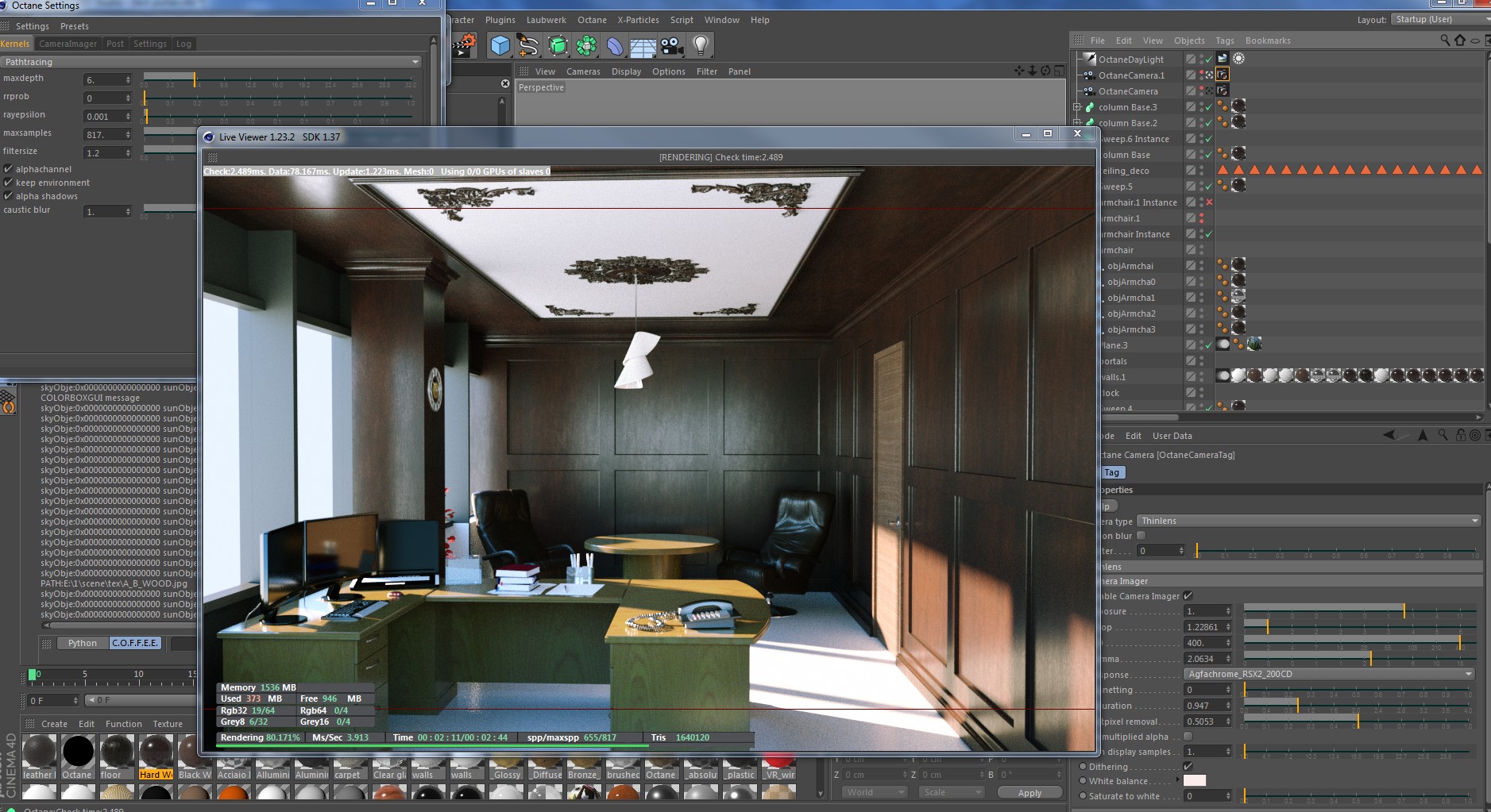

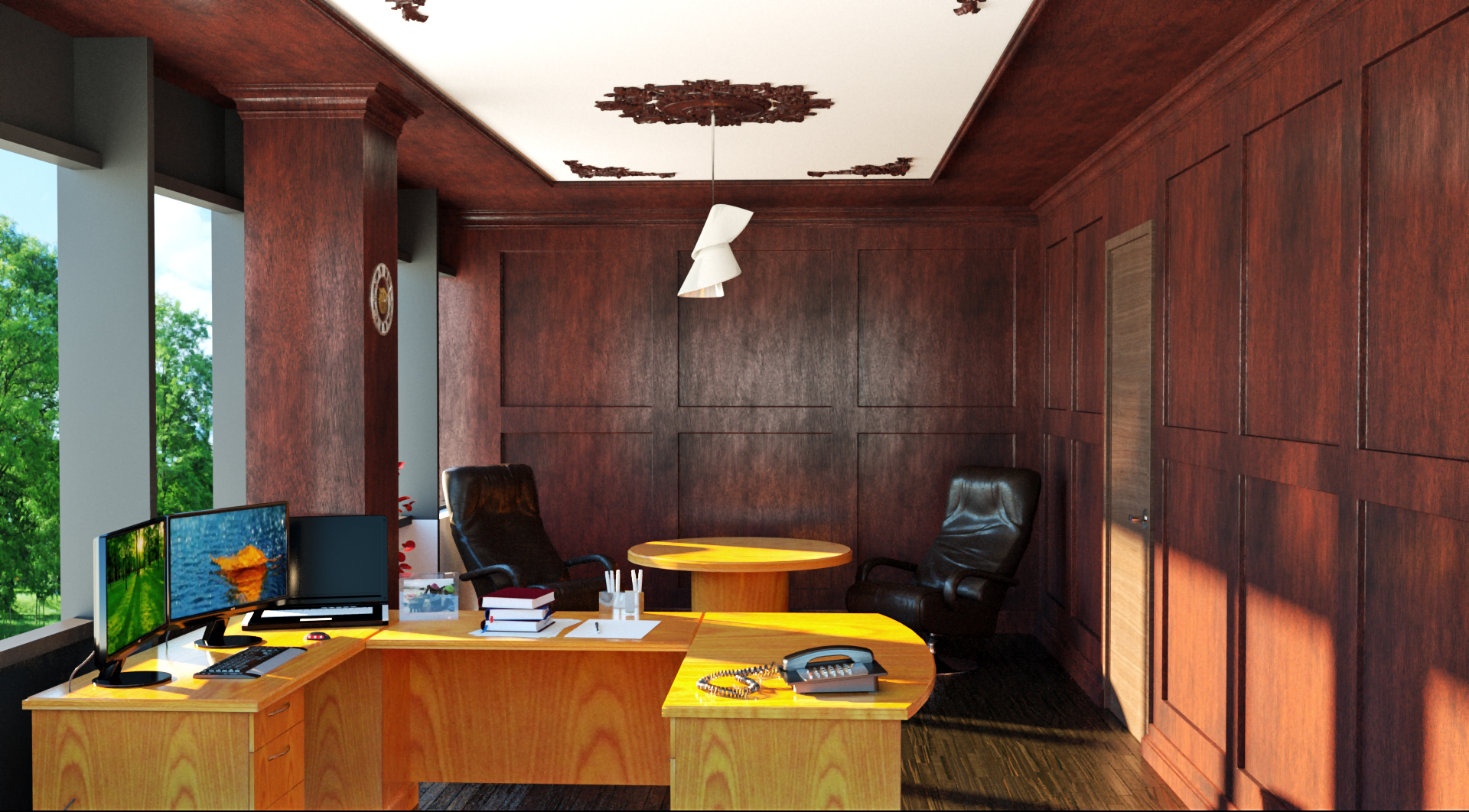

this is my test render for your scene. just 1-2 min. cooking. It has enough lighting to rid away the noises. Some critism, no need so much bounces for this scene, i did 6-8, also don't do the hotpixel removal is 0, keep between 0.5-1 if you don't have firefly.
And caustic blur is zero makes much fireflys, set to least 0.02 or more.
Also check notes of portal, it says must exactly cover openings. I'm not sure that's working well for all situations.
Hmm, your wood textures has not good colors. I prefer pro textures for good renders

For your scene, i have changed materials of wood wall and and table's. I never used too saturated and overbrighted textures. Also never give full white. Also, some hdri don't gives good results. You should keep in your mind.

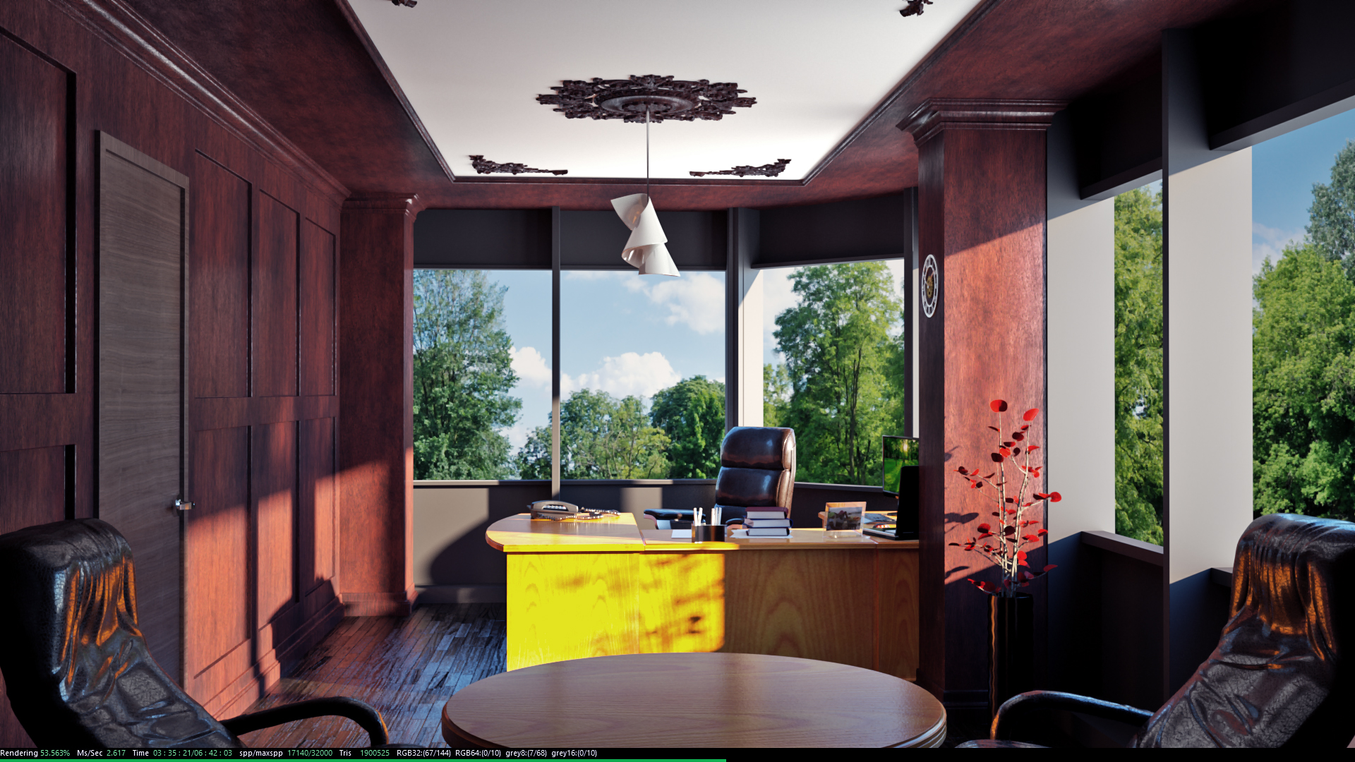

By the way this is the result after about 6 hours. Both took the same amount of time to render and i just rememberd i have used a sun, not hdri.

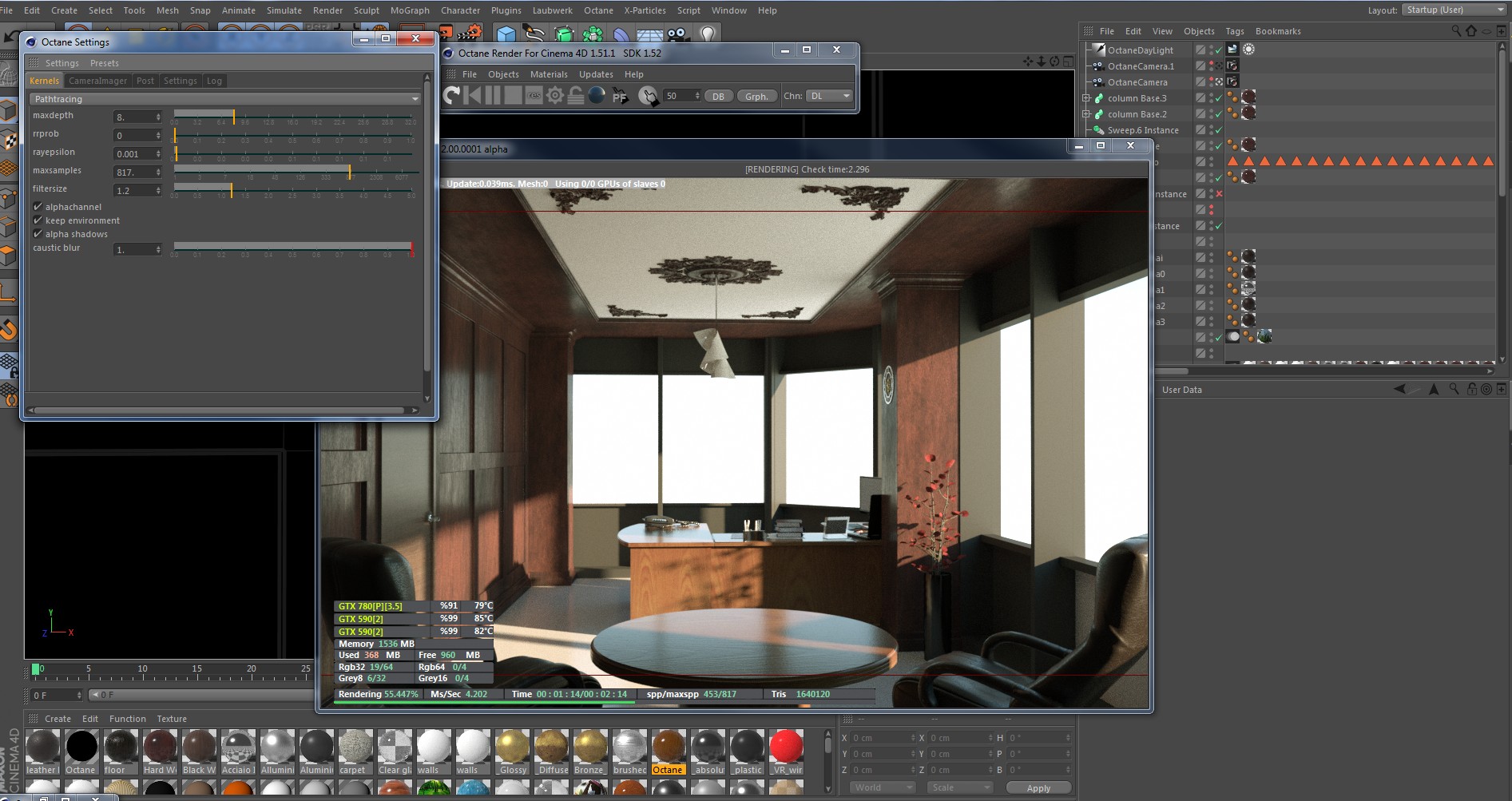

Ok, i have done some tests and i reduced the time alot. I get acceptable renders in 5-10 minutes using the tips you gave me aoktar. One question: isn't caustics blur for glass? I don't have glass in that scene, because i deleted the glass windows and placed the plane portals.

hi pavel,
i'm glad to see that you are solving your problems
about the caustic blur, not only the specular but also the glossy materials generate caustics, so if you don't need to see them, set the caustic blur to 1 for speed up the cleaning
