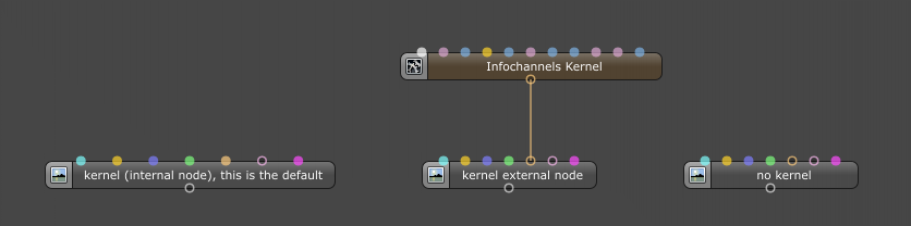

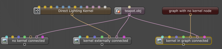

I think your code is fine. Could it be that you are confusing an internal kernel node (filled kernel pin circle) with an unconnected node (unfilled kernel pin circle)? Here are some examples (orbx file is attached):
kernel node test cases
Here's a small test script, just select a rendertarget and run it. Note that you have to modify getConnectedNode to getInputNode or the rightmost test case wouldn't work correctly - the script would find the output linker node but this isn't a kernel node.

When you add a render target (the left in below picture) it just has a kernel node that's internal to the pin. There's no implied render target or something, it's just a connected node but internal. The preview configuration has nothing to do with this. It's the config we use for the "material ball" (pre 1.50, this node was explicitely there).
It doesn't make sense to have a render target without a kernel (it will default to the wireframe kernel). Probably my wording was a bit misleading in the previous post. The code can safely assume that each render target has a kernel connected to it. To be safe we could filter out the render targets that don't have a kernel in the beginning of the script:
