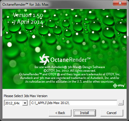

1st issue : DLL Octane3dsmax.dlr failed to initialize
Error Code 193- %1 is not a valid Win32 application
=> 3Dsmax 2012 64 / win 7 64
return to 1.31 :(

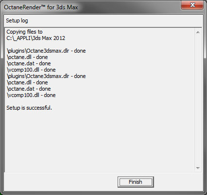

bicket
Posts: 365
Joined: Thu Mar 01, 2012 10:46 am
Karba wrote:
bicket wrote:Thanks KArba
return to 1.31 :(
Did you close 3dsmax before installation?
Yes i did. Detection of 3dsmax version and installation path is ok.
I think the extraction is not pointing the good archive.
