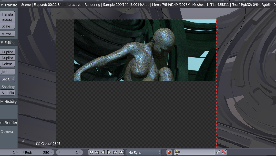

3 - Why Octane does not compute me all the selected thumbnail? (see screenshot)
