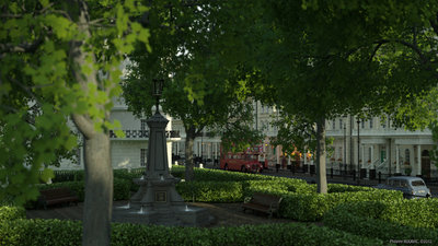

In this scene, the hedges have real modelled leaves, and the maple trees have planes with apha (I mapped 3 leaves per plane). I will work again on this scene and I plan try to rebuild the trees using geometry instead of alpha for the maple leaves.
This being said, instances are really interesting for medium complexity object. Too simple things like individual leaves require as much memory as non instanced, because the amount of objects coordinates becomes equal to the number of vertices of a more complex object or the number of pixels of a texture. So it is better to use branches as instances, rather than simple leaves.

Using geo instead of opacity maps sounds nice but, unless I'm missing something, is not easy to implement. All the trees/plants models from XFrog, Evermotion, Tree Sketch, etc, are all non-instanced flat planes with opacity maps. This is the standard way foliage models are produced and sold. Having to recreate all the leaves manually for each one is a huge time-suck, and doesn't seem like a viable option for me.Daniel wrote:It takes a lot of calculations for rays to pass through a whole heap of invisible geometry. It's much better to modify your leaf geometry (which I'm assuming is one quad), cut it a few times and modify the shape to as closely resemble the texture as possible. It will increase the polys of each leaf by 4-5 times, but you should see a performance increase.
I can understand that alpha maps increase render times, but in MODO, I'm used to that being a max 50% increase with trees, not a 400% increase like in Octane.
I agree that it is not obvious with trees bought in packages. I mainly make my own trees. You can start on the basis of trunc and branches of your existing models, and add sub-branches with modelled leaves as instances...
