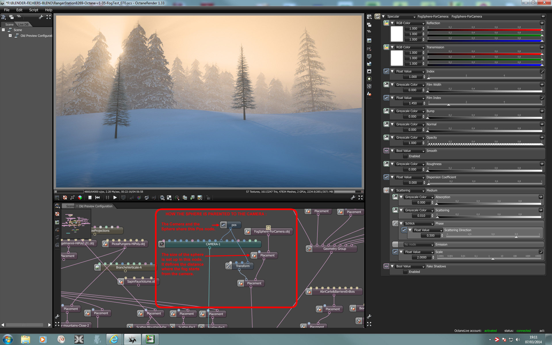

Hi, It is easy to parent an object (typically a sphere with normals Inside for fog/Scattering Medium) Inside Octane Standalone using ascendent links and a Position node shared by the camera and the sphere, but is there a way to extract transform data from the camera of an Alembic node ?
Below, just to remember, how to parent the sphere to a regular camera :

You should be able to click on your render target, select camera, then click where the name is (or somewhere around there I think), copy and past to your node graph. I was doing this with other things last night. It will give you a node with all that data. Worked with kernel settings when I was testing.

@Kavorka : When a camera (I need an alembic camera because it is animated) from an alembic node is used, position node is not present in the Render Target ! :roll:
