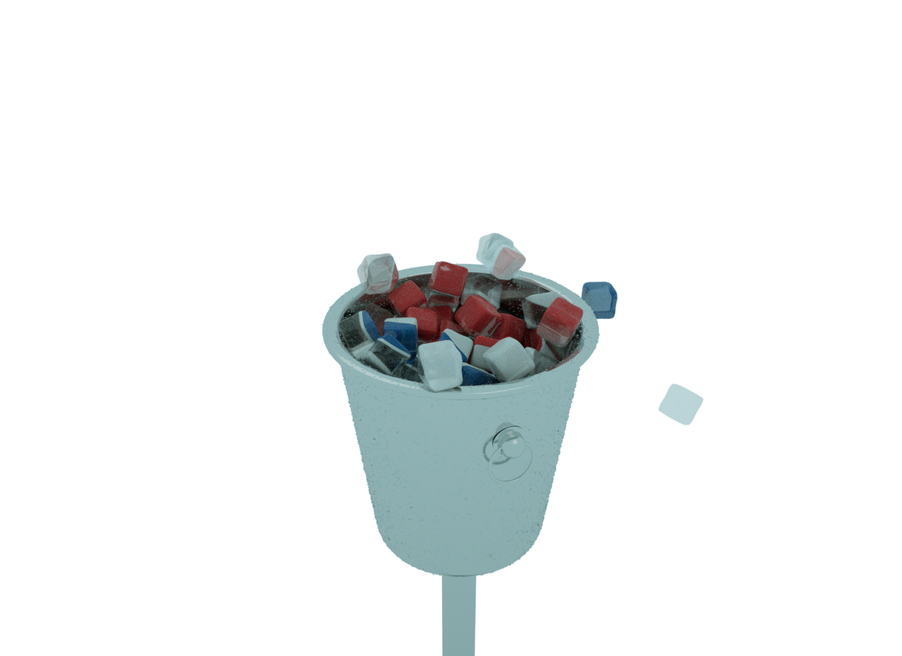

Hello,
I have a scene where i want only the hdri sky reflections on my objects and a radial gradient in the background. Can someone please tell me how to do that? I have tried several methods, but no success. I created the hdri sky, i created the radial gradient material and i put the gradient on an octane texture environment object, but than i don't see the sky reflections anymore and the background is not radial.
Thank you.
