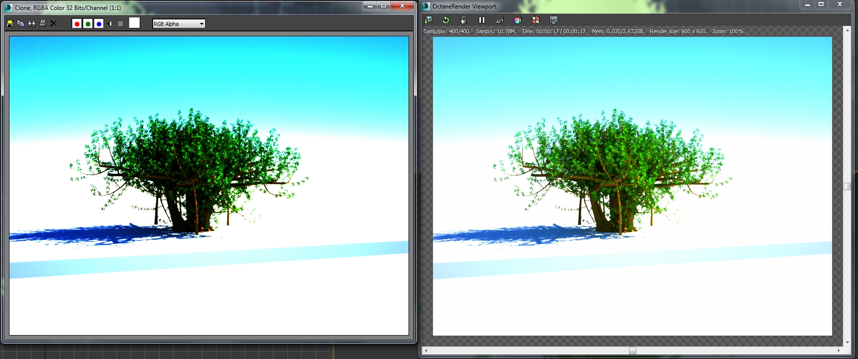

I´m fully aware of how to work linear. What I try to say is that there is a total change in the way image behaves when copied to frame buffer. As an example see image. This is rendered linear, gamma 1.0 and copied to frame buffer. Max gamma correction is turned of, so it shoul´d look the same. at least that´s what it used to but now it looks like this.. I know this is only 24bit but you still se the differense

I tried my scene in 1.25 and everything works fine again. So it looks like the problem started in 1.31.

That was some perspective on it. Thanks. And it´s clearly stated that it´s a change sins 1.31 over previous ones.
