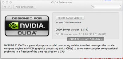

i have updated my cuda driver to 5.5.47
and installed the latest octane-c4d-plugin version… (TEST VERSION 1.20a)
nothing is working… :(
mac pro/osx 1.8.5/c4d 13

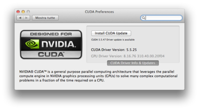

please, could you explane a bit more what happen?
here is my cuda panel in os x 10.8.5:
ciao beppe

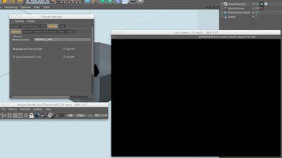

as i wrote, i have the newest drivers installed... (cuda/cpu) and tested with various octane-plugin versions... but my octane-liveviewer-window is black...

klick send scene, but i always have only a black live viewer… with version 1.23 too… :(
