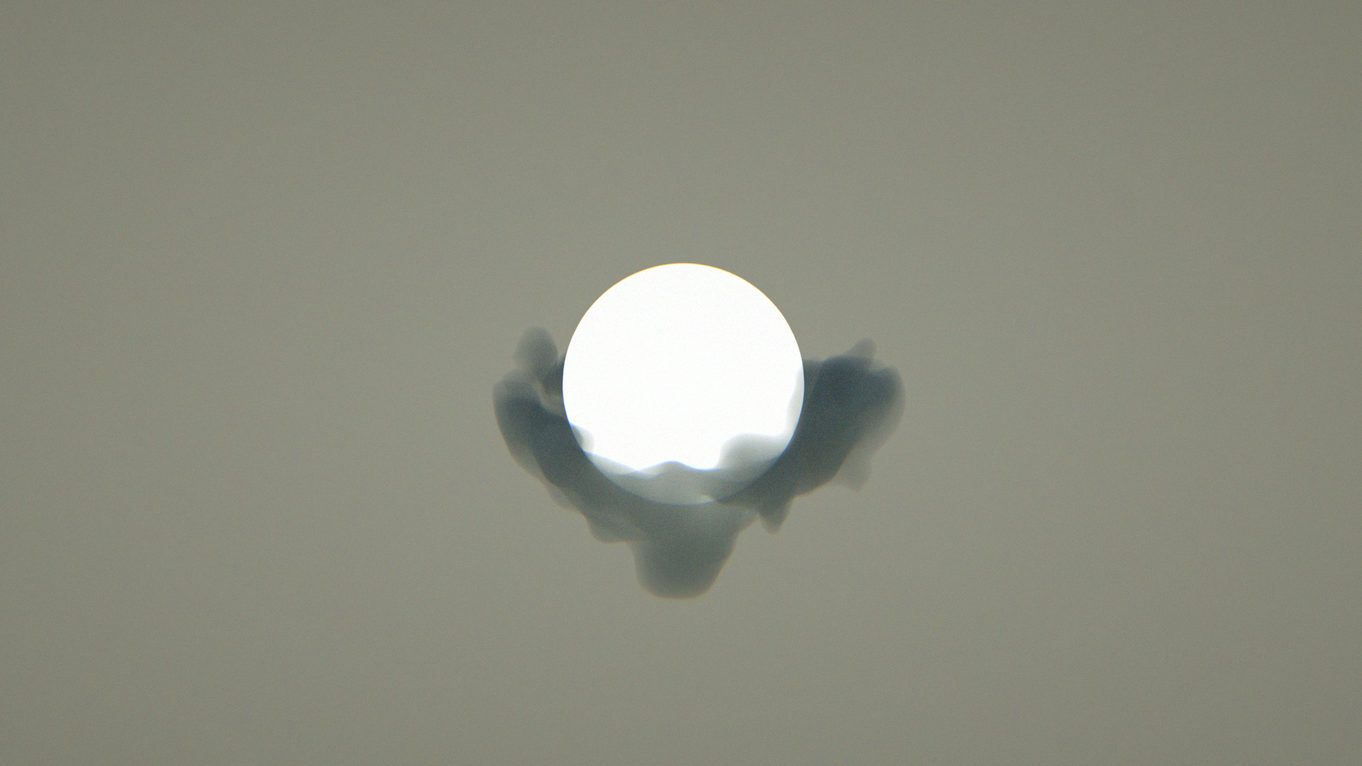

No that isn't possible. The most you can get is a fairly cartoonish smoke render. The problem is that you have to convert your volumetric smoke/fire (voxels) down to the hull (mesh) and from there you can add an fog material. You will lose every fluid and color information inside the "hull". Here's a test I've done (colored fog material on a smoke hull):
