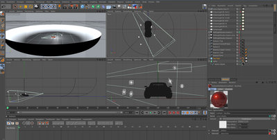

How does your Studiosetup looks like?

For the Studiosetup, have a look at this image: Used a Spline in a lathe nurbs to get a big bowl as 360 degree studio background. Mainly lit with HDR Studio Light, then some IES lights to highlight certain areas, like the rims or to add some backlights. Used IES lights, because I didn`t got normal area lights to only light the car without hitting and lighting the floor.
For the Mercedes Shot I closed the top of the bowl a little bit with a flat tube, to simulate a cap with a whole in the middle and darken it up, so also the HDR light that comes in is limited... Maybe this can also be done only with HDR lighting, will give it a try next time.
