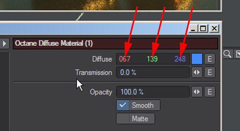

Color pickers in Lightwave are not dynamic, so I can't change the colors without select a color and close them ... but you can change in real time the color parameteres if you click and drag over the numeric values of all the color widgets, and even change them to HSV if you right+click over them.gordonrobb wrote:I just wanted to discuss a few differences between standalone and plugin, that I wanted to know if it was possible to fix.

Not sure I understand this bit. Can you tell me what you mean?juanjgon wrote:.. but you can change in real time the color parameteres if you click and drag over the numeric values of all the color widgets, and even change them to HSV if you right+click over them.

Woh! Going to try that right now
