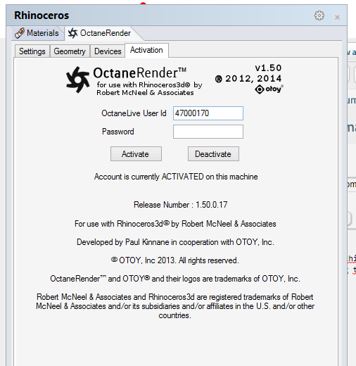

Hi Paul,
Here's a screenshot of my Octane plugin in Rhino. I am exporting my models to .ocs by right clicking inside settings tab and choosing "Export Scene to OCS", so perhaps I am using the plugin itself to export.

Hi - thanks for the screenshot.
To answer your original question....
I'd like to ask if there is a way to export .ocs files from Rhino including various rendertargets, geometry variations and material variations?
I'd like to batch render an interior scene that has, let's say, 3 different cameras set as well as 4 different geometry/material variatons. For batch/queue rendering itself I am using a Lua script found here in the forum for which works perfectly.
For the scene loading - so far I am able to export .ocs scene which includes everyting that is ON at the moment of export (camera position, layers and materials that are ON, etc.). I can do this manually for every single option and camera position (that's 12 ocs files) and then combine the nodes from different .ocs files into one. But that's a hell of a work I have to say. So I wonder if all this can be done in easier way - like exporting an .ocs with various Rendertargets and all the materials and layers in the scene (even the ones that are OFF at the moment). Or loading previously saved .xml file with Rendertarget settings into standalone?
I see what you are after - however I don't think there is an easy way to export 3 camera positions from the current version of the plugin. The two options I see are 1) use LUA in Octane Standalone to merge the different OCS files (unsure how easy this would be), or 2) Use Rhino script to automate the process of exporting each OCS file. At the moment saving to OCS is not available as a Rhino command, but I could easily add it....but it would be in the Octane 2.0 version of the plugin.
So in summary - this is possible, but not straightforward.
