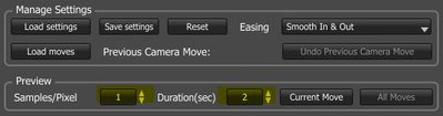

I tried implementing this today, octane.gui.NUMERIC_BOX, but i could not find any documentation of its properties in the api browser.
Am I blind?
thx
Mark
