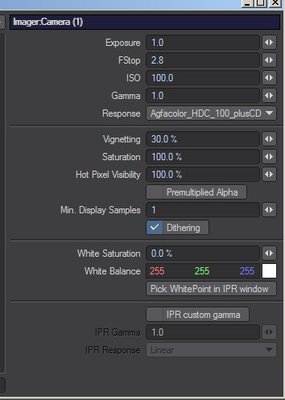

What do I need to do with newly plugged imager node to get the same image colors and contrast I had before plugging it in ?
juanjgon
Posts: 8867
Location: Spain

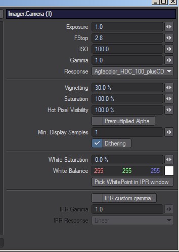

I think that the only thing that you need to change is the camera response parameter to "Agafacolor_HDC_100_plusCD". This is the default response in Standalone.
