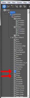

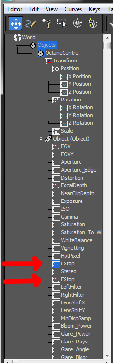

This one is just using Octane cameras. You can set up the three key values, FOV, Interaxial and Zero Parallax using the sliders, or you can set the Zero Parallax using the ZeroParallaxDummy.
I would have linked the values directly from the camera using Maxscript, but for some reason the Octane camera controllers have $fStop for setting the fStop value, and also $fStop for setting the stereo control (screengrab attached along with the Max scene). So this way everything is set from the sliders and Max doesn't get too confused.
