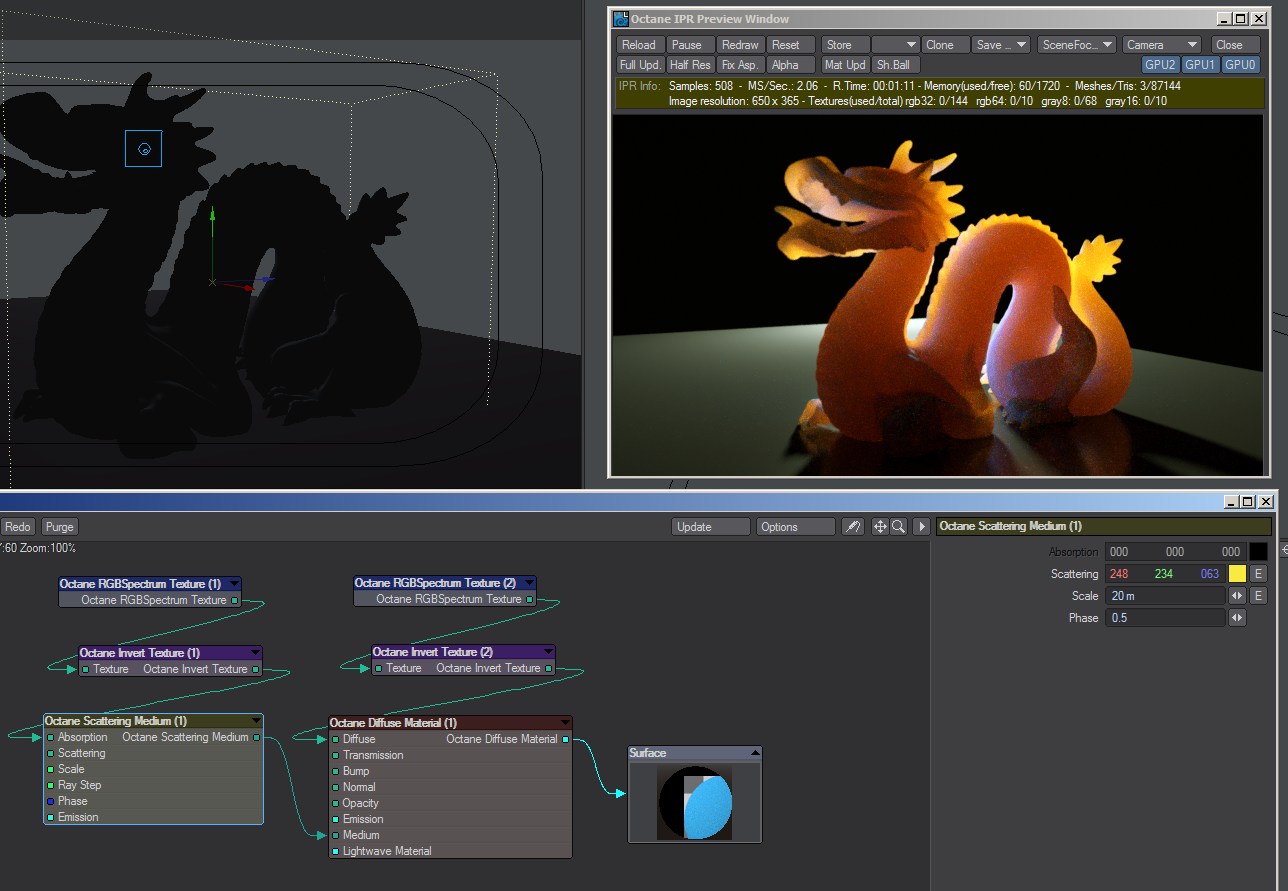

Dont have octane in front of me. But I think you need to use the Medium input of a diffuse material. There's a Scatter node that you plug into it. Mess with the Absorbtion, and Scatter settings along with the scale.
Best bet is find a SSS material you like in the Standalone app, and then try to copy over the node settings from that.

Yeh, or Jaun's idea would work too

Thank you!! Not seen that scene before. I'll check it outjuanjgon wrote:You have a example scene in the plugin .zip file "dragon_sss" with a very basic setup for a SSS surface.
