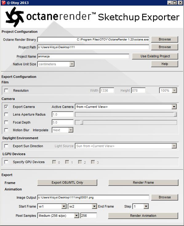

I want to report a bug when creating animations.
My project is called "animacja". Unfortunately, the plugin creates a file animacja_anim.obj but trying to load animacja.obj and pops up an error.
I have one more question. In "Step" I can only select "1". Is this normal? How to make the animation between the two scenes generated eg 48 frames (2 seconds of movie)

skibbbi wrote:Hi TIG,
Thank you for your time and hard work. Thank you very much.
Regards,
Before making an animation 'set' you must have made a #base OBJ file# in the #export OBJ# or a related 'Render one frame'.
Then that needed OBJ will be found, and so the remaining ..._anim.obj files will get processed.
If you specify scene w1 and that is followed by w2 AND there are no others in between, then logically you can only have ONE step.
That is the default [i.e. it steps through each scene].
If you have scenes w1, w2... up to w101 with step 1 that is 100 steps at '1 step'.
At '2 steps' its 50 etc...
You need something like the KeyFrameAnimator Plugin to make all of the scene tabs in order.
The a lot of patience... as it takes hours to render all of the frames ! :geek:
