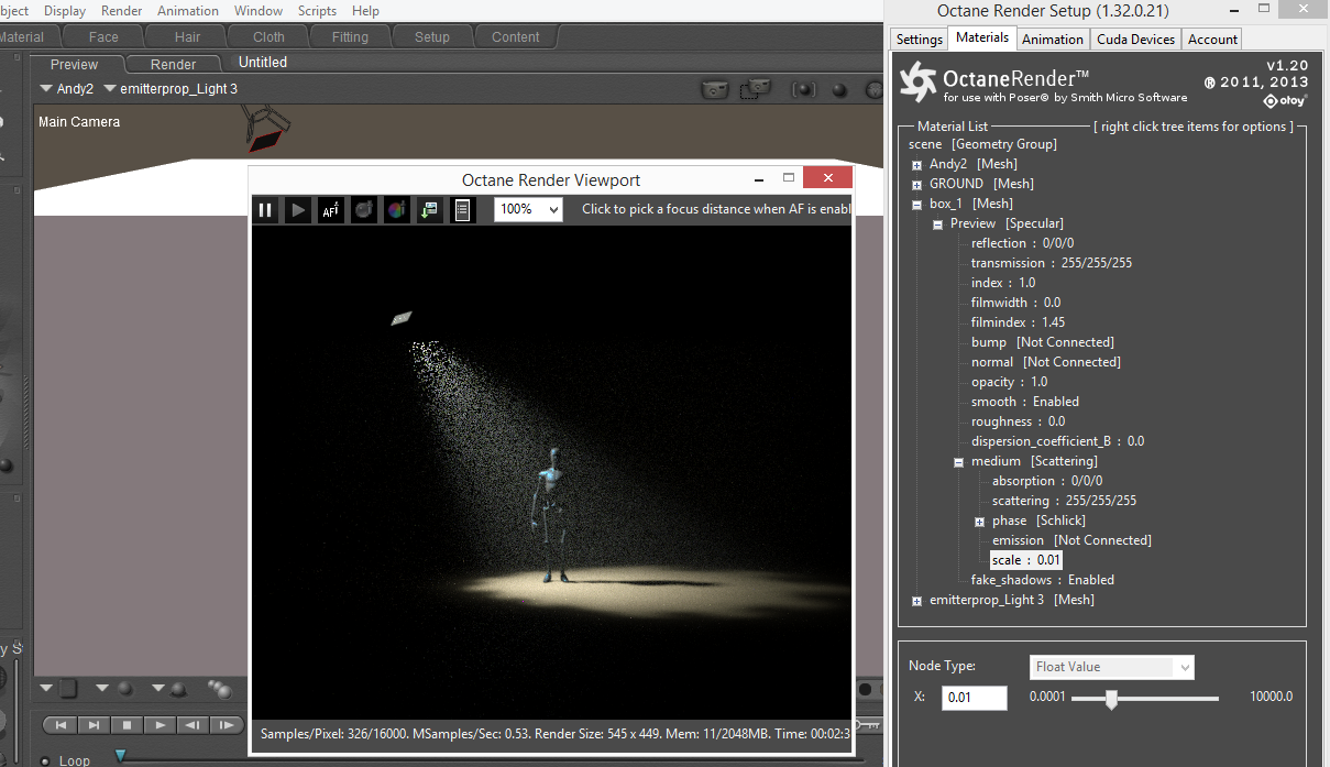

Yes - this is supported. There are a few tutorials here in the forum. In summary, load a Poser primitive box into the scene and enlarge it to cover the entire area that will have the sunbeams. Then setup the material for that box as a Specular material, with SSS (scatter = white, absorption = black, Schlink = 0). Use a small scale to start with (0.01 for example). The camera must be outside this box. Unsure if the lights need to be outside the box or not.
Suggest getting this working on a blank test scene first, since it can take some tweaking to get right. Remember to use PT or PMC kernel. Remember to put a Transmission on your box material of white (to get the SSS working). Reduce hotpixel_removal to clean the render up.

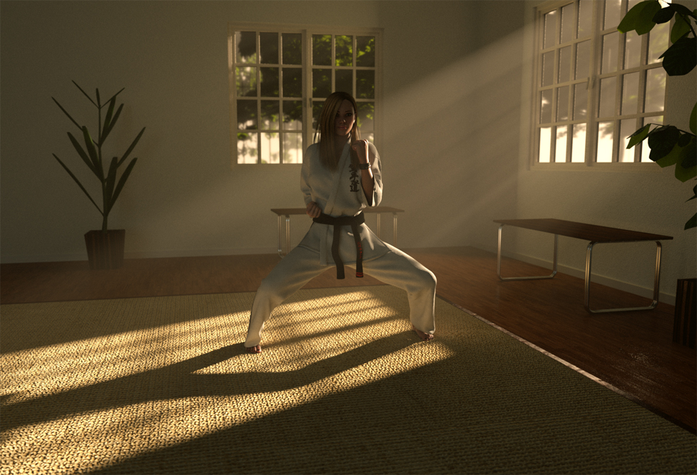

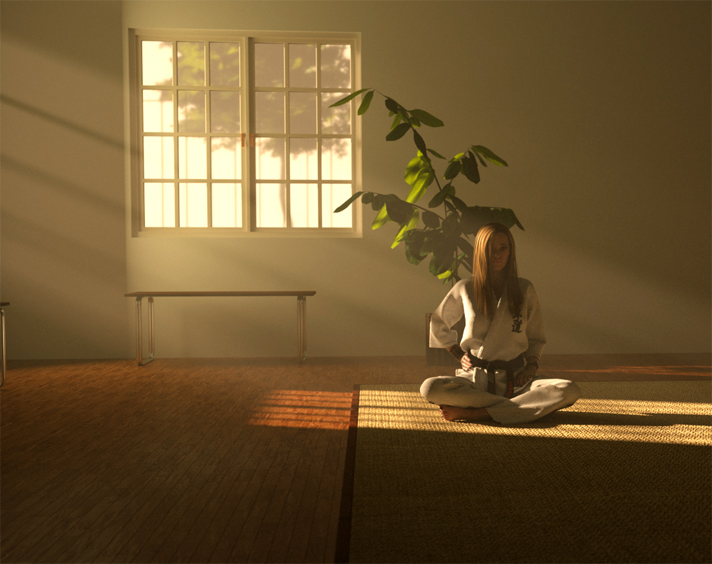

I recently had the similar idea of trying out volum. light.
Here're 2 pics (reduced and all that) I came up with.
Not quite perfect, I know, but I got the idea, of how things work =)

What I also found is, that it was and still is incredible hard (well, for me at least), to find a good light balance of interior and ex. light from and with the sun. Took me quite a few runs.

Looks like exactly what im trying to do, did you use sunlight for outside light or HDRI?
I strugle a lot with indoor lights and the mesh over running (ligth goes all over the place) the rooms. IES Helps some but still a struggle

I know, you're asking about using IES or an emitter, but you're right, I used sunlight, for my renders.
I have yet to try this with IES tho =) .. I have to admit, so far I didn't have much luck with IES driven renders.
May it have been extreme noise, the positioning of the "light cone" .. etc ... yea .. still trying and learning ... trial and error, so to say :P

Erick - outstanding render!
