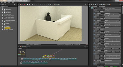

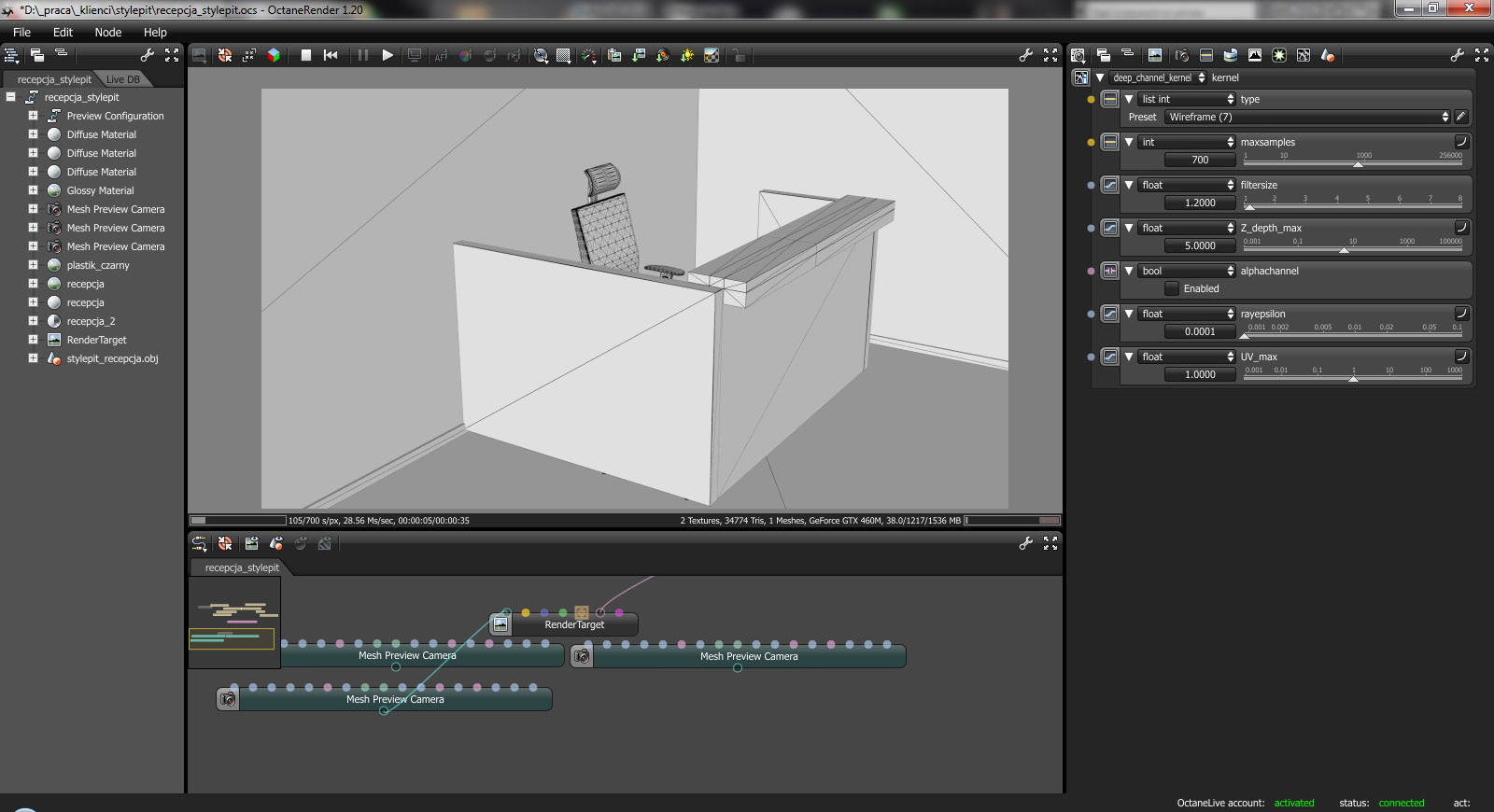

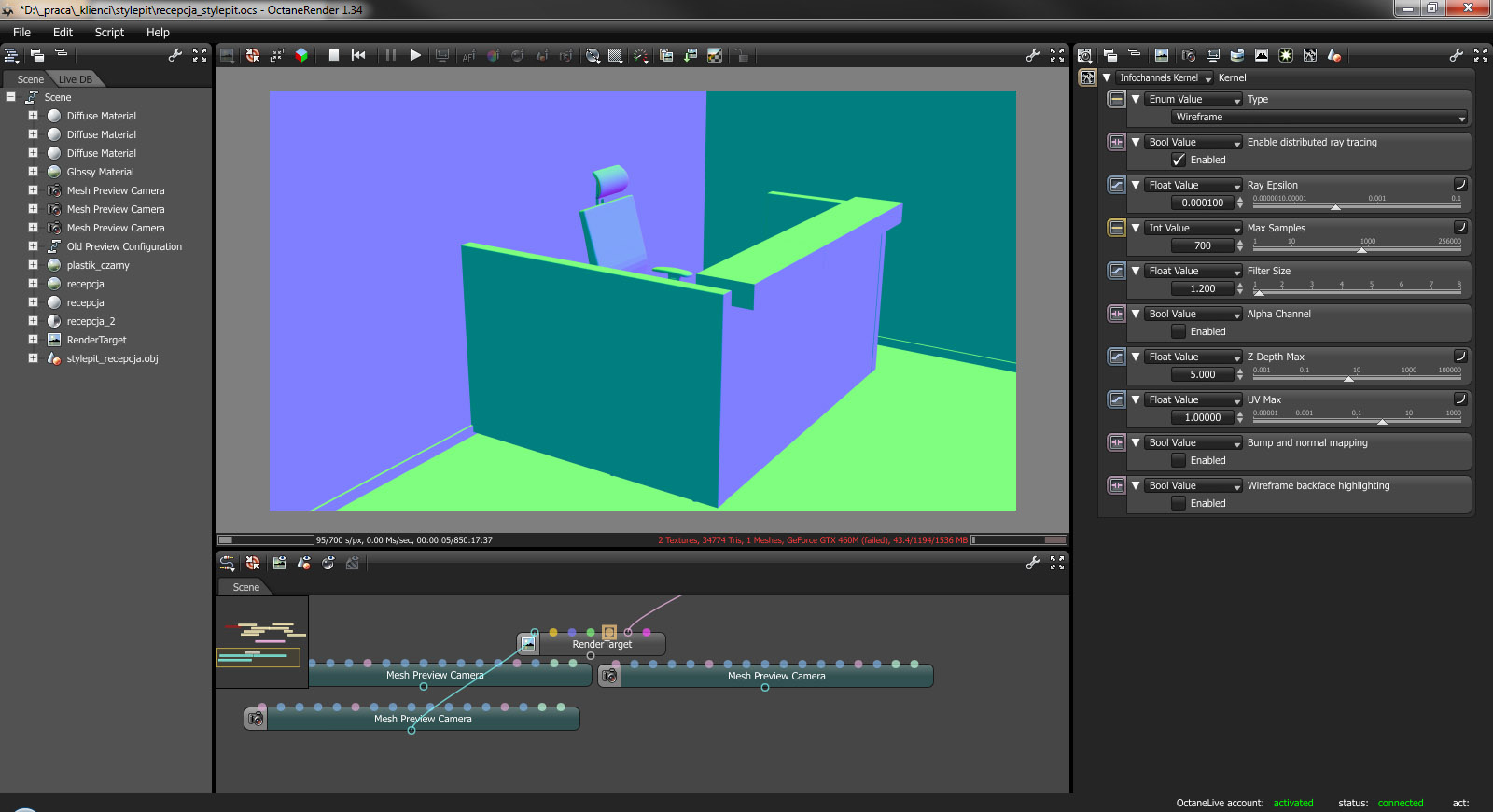

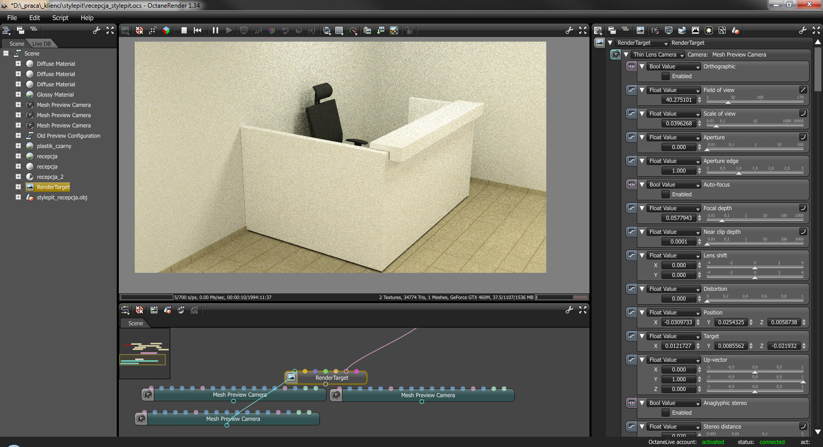

GPU failed after switching to Infochannels Kernel
It works, whith geometric normals, failed with Wireframe mode
It is a very simple scene. I've tested a few other scens. Results are the same.
Octane 1,20 works fine
I've tested only on my laptop with GTX460M
M.
octane 1.34 PT
octane 1.34 PT
octane 1.34 Infochannels Kernel Wireframe
octane 1.20 wireframe
win7 64/core i7 920/32GB RAM/3x GTX 580 3GB 4x GTX 970 4GB/blender 2.79/Rhino 5,0/octane 3
win7 64/core i5-460M/8GB RAM/GTX 460M 1,5GB/blender 2.79/Rhino 5,0/octane 3 (ASUS G73JW)

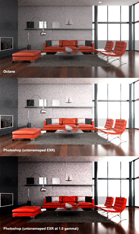

You have misunderstood. I'm not talking about a gamma difference. I'm talking about a difference in exposure (brightness)
In 1.20 the camera imager controls were not taken into account (exposure/fstop etc) but since 1.30 a new method is used and all these controls affect the saved EXR.
eg. In 1.20 I could use the following camera imager settings:
exposure = 1
fstop = 1
iso = 55
gamma = 2.2
response = LINEAR (no camera response)
The brightness of the output of the tonemapped and untonemapped (once gamma corrected) would match. In other words, photoshop would look just like what I see in octane.
In 1.34 this is no longer the case. I need to adjust the EXPOSURE (not gamma!) of the untonemapped EXR in photoshop by -1.35
I have attached a file showing this is not a gamma problem. You can see the first image from octane, the second is the untonemapped EXR (as shown by default in PS), the third is the EXR with a 1.0 gamma. The second image should look exactly like the first.
