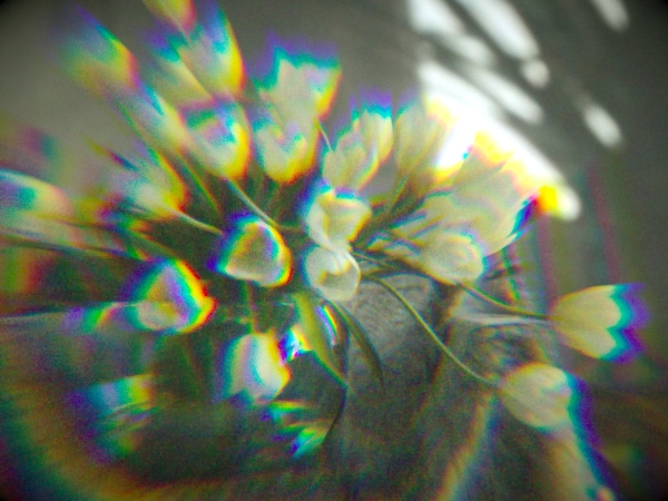

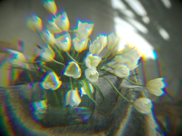

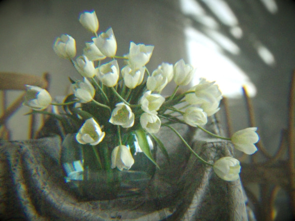

Upon setting up a Specular box for atmosphere/haze in another post, I accidentally ticked the 'dispersion' box and noticed this:
DISPERSION 0.1
DISPERSION 0.1
DISPERSION 0.05
DISPERSION 0.05
DISPERSION 0.01
DISPERSION 0.01
DISPERSION 0.001
DISPERSION 0.001

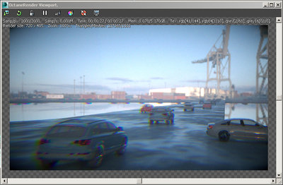

Dionysiusmarquis wondered what it would look like in animation, so I set this up (super quick) to test. Sorry about the overexposure:
TEST H264.mov
DISPERSION 0.01 - PMC 2000 - 17-24s/frame - 2 Titans
(1.19 MiB) Downloaded 25749 times
In the animation, I did not use SSS in the 'haze box', but simply turned on diffraction to get the effect to not have a massive increase in rendertime. 17-24 seconds on PMC! Setup was dead-simple: Specular material, turn reflection off, turn dispersion on, set IOR to 1. Fake Shadows ON.
Check out the rendertime!
Not that I am a huge fan of CA, but could be useful for certain effects...

Yeah! haha that's great! I wonder why the effect only gets stronger to the left in the video.
Olitech
Posts: 447
Joined: Thu Apr 25, 2013 4:27 pm
dionysiusmarquis wrote:Yeah! haha that's great! I wonder why the effect only gets stronger to the left in the video.
I wonder if it's because I used a Box?
My camera is not perpendicular to the haze box. The focal point should be in the center, and the CA should be more pronounced and the edges, like the top Tulip example.
In the Tulips, I had the box perfectly perpendicular to the camera angle. I just checked this car file and realized my haze box is square to the scene, but not the camera.
I'll do another and exaggerate the crap out of it.
best,
O

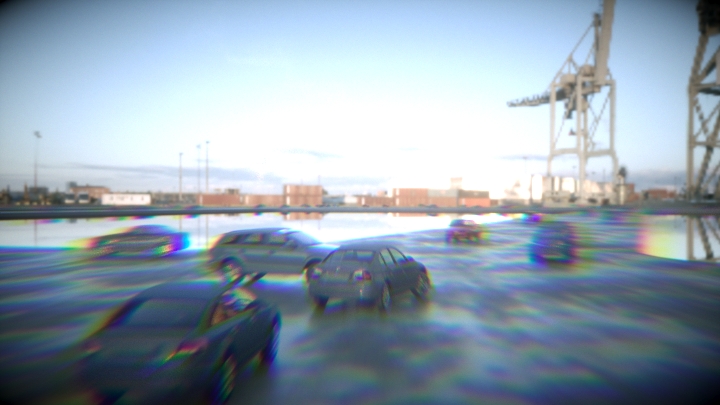

Olitech
Posts: 447
Yep,
That was it mang!
best,
O
