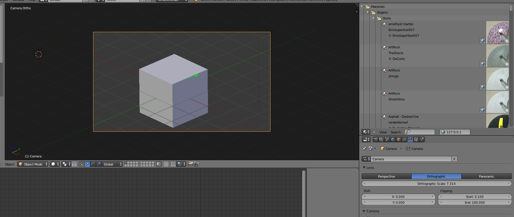

It is just not Octane problem. It's some Blender's lack of features.
As you can see - Blender does not have a special viewport look for panoramic camera - only for perspective and orthographic. So, Octane plugin's code can't "match to nothing", if there is nothing to match to in the viewport. As in Octane's panoramic camera mode (the same as in any panoramic camera mode) - Blender's viewport shows the perspective camera view. But panoramic camera node is very different from perspective one, it has absolutely different settings, and it can't match to this perspective camera view and to its clipping box in this view.
Moreover, Blender knows nothing about some of Octane pano-camera settings, so even if it will learn in feature how to show pano-camera inside viewport - it anyway will be not able to match Octane's camera without massive Blender's core code changes... So, in this case, all the plugin can do - just fit the full image into viewport or into render-result...
But anyway, your report is not forgotten, I opened the ticket right after you've posted it, and will try to make some improvements in this regard. Just some later, after more important things will be finished.;)
