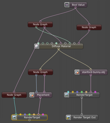

Here's a visually what the script does:
select the root node of the tree to copy and hit alt+c

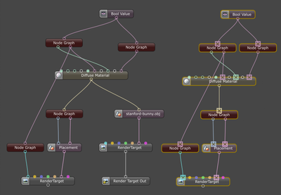

here's the result (I already moved the copied tree to the right)
