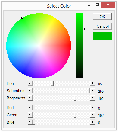

face_off
Posts: 15757
Location: Adelaide, Australia
Yes, sorry, Rhino6.
This was the color picker I had in mind.
Paul

jitendra
Posts: 143
Joined: Sat Oct 16, 2010 6:09 am
face_off wrote:Yes, sorry, Rhino6.
Paul
This would be great.
I will be looking forward to that. :)
Best Regards, Jitendra
jitendra
Posts: 143
Hi Paul,
I just downloaded new plugin and this color selector is very nice. Great improvements.
However, the instant update still is missing. So, every time it requires to press OK to see the changes. Is there any possibility to have instant update?
Also, it would be great to have a field where we can directly feed in at least RGB values or may be # color codes so that, copying and pasting color is more easy.
Thank you.
