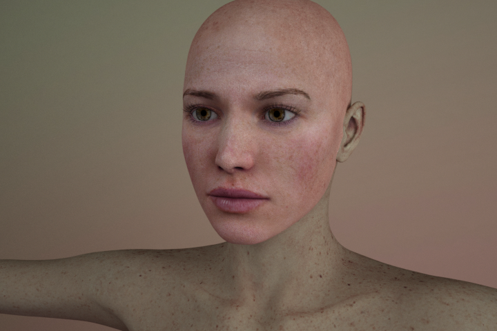

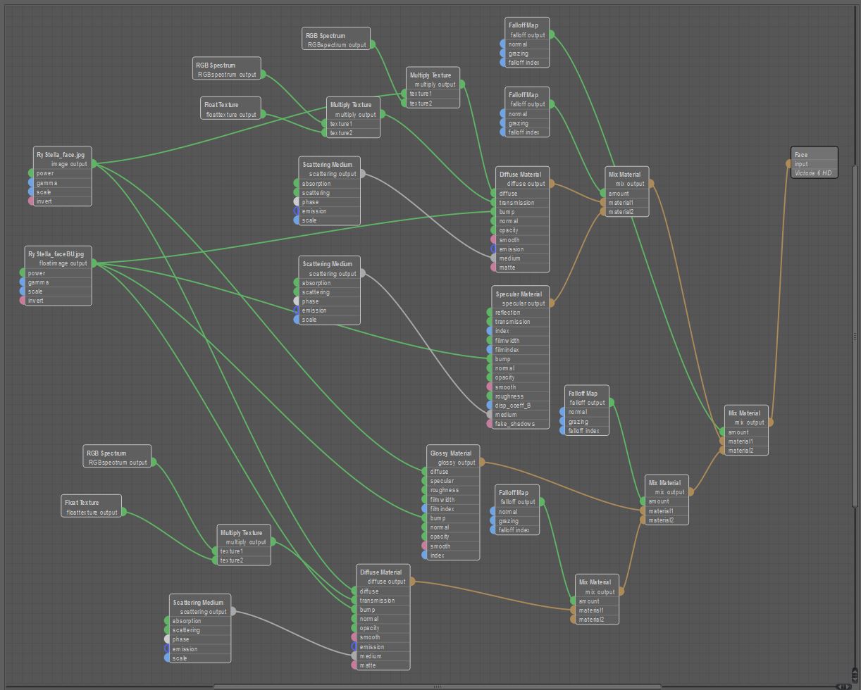

Creating a good SSS Skin is not that easy. There are multiple ways of doing it however. I would recommend working with the NGE instead of the Live materials, since you cannot ungroup a Live material as far as I know.
I will write a short tutorial on how to create a good SSS material for use with Diffuse/Bump textures this weekend.
Here is the preview for the NGE
with the result

3dmania wrote:Creating a good SSS Skin is not that easy. There are multiple ways of doing it however. I would recommend working with the NGE instead of the Live materials, since you cannot ungroup a Live material as far as I know.
with the result
looks pretty good. btw, ungrouping works by extracting pins (alt-click->pin->drag-out), but i'm also working on an unfold method that creates an external node structure out of any collapsed node; it will keep nodes used in multiple pins as single nodes, will unfold pins when the value is different from the default value, and will create single external nodes for any pins that share the same settings.
oh, and btw, if you like to share this particular setup, you may save it into a single shader .duf (from any of the daz surfaces where you have applied it) and post it here for dl.
setting up the image nodes as templates will make it work whether the maps you have used are on a target system and will of course make applying it to other mat sets easier - would be cool to see if this works (may need some bug fixing though)...

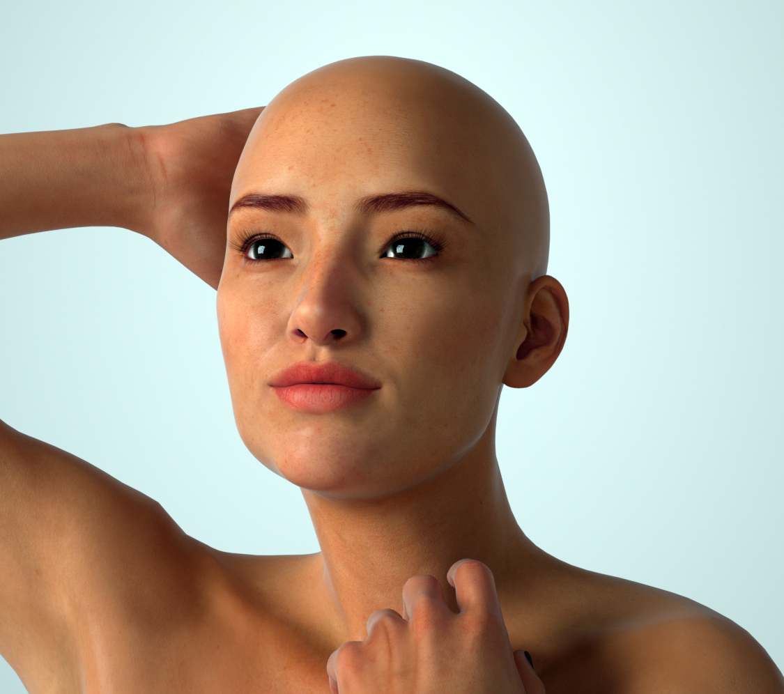

michael_g
Posts: 28
Joined: Sun Dec 15, 2013 8:07 am
Low sample, low res test DAZ_SSS_Skin_Mix_Diffuse&Glossy with the amy elite texture set, original textures on the neck and shoulders compered to the DAZ_SSS_Skin_Mix_Diffuse&Glossy on her face, It`s a total pain loading in all the textures one by one but it looks pretty good.

Thanks for node graph
