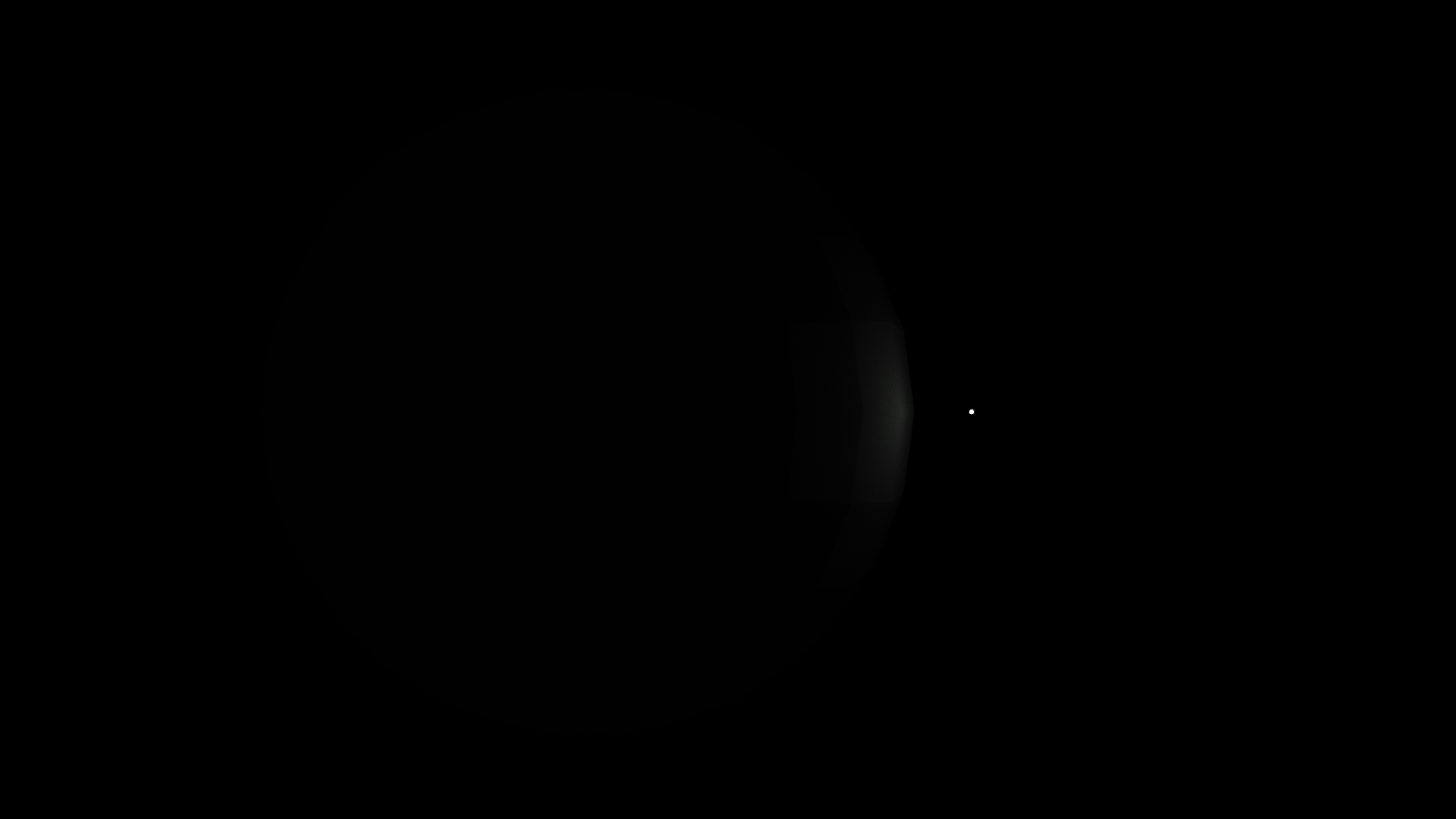

See attached OCS file ... I tried lighting up my spacestation a bit with a huge light emitter ... but even when set to 10'000, the light is so oddly weak, it hardly illuminates the spacestation to levels I'd expect, when the slider of the emission power is all up...?

I get this behaviour lately too, I can't use my HDRI sky environmets because they are just too dark when set to emit. Is it a normalize issue ? HDRI domes are huge, does this affect emission power ? Now I have to punch exposure up to see it.
BorisGoreta
Posts: 1424
Joined: Fri Dec 07, 2012 6:45 pm
Yes, emission is normalized, the huge and the small sphere have the same emission properties, yet the small one seems much brighter.

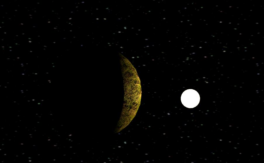

Did you try one of the light from the LiveDB to get a starting place.
planet and moon emission
Both the planet shader and moon are from LiveDB
