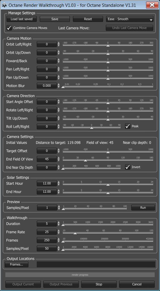

Here is a script that can be used to create a walkthrough of an Octane Scene. Conceptually a series of camera moves can be record in a sequence of files. Multiple sequences need to be combined in another application such as Windows Movie Maker. Each camera move can be a combination of an orbit, pan, zoom, tilt, rotate, roll, sun path or depth clip operation, optionally each move can have a quadratic easing function applied to it. Camera moves can be previewed before saving as an automatically named file sequence based on a seed name.
The script combines multiple works by Thomas, Roeland & Jason, without them this could not have been done in any reasonable amount of time, so many thanks to them. It will run against OctaneRender release candidate 1.33.
In my mind the script is now functionally complete but please report bugs, I will keep it running against newer release candidate.
To use; extract to a folder and then point Octane File>preferences>application>script directory at that location.
REVISED TO RUN WITH OCTANE RENDER V1.50

First impressions - very good.
I was wondering though if daylight is actually necessary.
Presently the script gives an error without it.
Possibly people want to make night or indoors sequences too...
With a tool like this we wont just be thinking of outdoors orbits.
Maybe a checkbox to enable solar settings with warning tooltip?
There is a little intuitive issue I think with the directions and the settings
Orbit should be Down/Up so - and + are consistent across all sliders IMO.
I think of down as negative
also same for Back/Forward, Pan Down/Up and Rotate Down/Up

Pixelrush,
Your points are well taken and I will look into implementing.
I was thinking the same thing re positive and negative values on the sliders and was hoping that otoy could perhaps improve the slider control so that to the user at least it could be presented as positive in both directions around zero, as the current word order is more natural than the reverse.
Regarding daylighting, if that restriction is removed, does it mean we need to be able to rotate an HDR background image, and also is there anyway in the new releases to combine both HDR and daylighting simultaneously.
